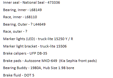

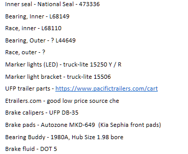

            Wheel bearing inner seals are 99.9% of the time off the shelf standard parts. You may need to pull a hub and remove the existing seal to ID the part. There will be number on the rubber portion of the seal that just about any auto parts store can look up and order. Or, in the chance there is no number, measure with a caliper the diameter of the hub where the seal rides and the OD of seal. A good parts guy can find the right part based on these numbers.
            Good tip:
            Keep a OneNote or something similar with a catalog of all of your trailer part numbers - wheel bearings, races, seals, brake pad, hub and axle manufacturer. If (when?) you have a roadside breakdown and need to hustle parts, this list is a lifesaver - you call the autoparts store and say you need standard part X part. Bang...solved. If you call the parts store add say you need a wheel bearing for 2004 model year DHM dual axle trailer...you get a whole lot of nowhere.
            Here's what my cheat sheet looks like.... (for my 2004 DHM dual axle trailer!)

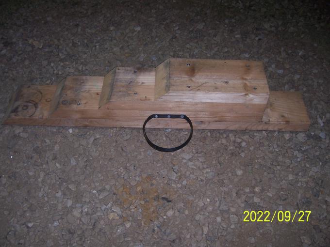

                When I'm towing a tandem many times it's between 500 and 1500 miles. I don't bother to carry a jack for reasons above they either are too short or unstable. Took a tip from travel trailer guys and built a small ramp out of 2x6's. Use it around the garage when working on the hubs as well. Throw it on the ground either pull forward or back up depending on which wheel needs to come off and it's done Click image for larger version
