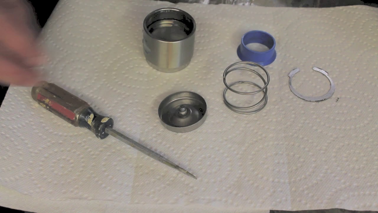

      OK need some help. Tried to top up the grease on one of the bearings today and my zerk got stuck (again...this pump needs to go to the trash). In removing it, the zerk broke off out of the blue plastic housing (or it may have already been broken given my earlier picture of a bearing covered in grease...it is the same one).
      1) What is this blue plastic housing called / where can I get a replacement?
      2) What does replacing it entail? Do I have to remove the wheel? Or can I pry it out and pop a new one and top up with grease?

        I don't know that you can buy the internal parts separately but here's a video of how they come apart.....
        If you're missing parts or something got damaged they you're pretty much going to need to buy another set. The big thing is to get the right size which will entail using a set of calipers to measure the inside diameter of the of the hub or the outside diameter of the bearing buddy. The inside of the hub is probably more reliable as sometimes the case of the bearing buddy will get slightly out of round when you remove them.
        As for removing a bearing buddy..... The bearing buddy is install with a pressed fit. As such you're going to have to use force to break it free of the hub. The way I do it is with a block of wood and a good sized hammer. You don't have to remove the wheel but it will make getting a good swing at the hub easier and you won't have to worry about a miss with the hammer or a glancing blow hitting your wheel. As such I would recommend the following.....

          Thanks. Sounds like I need to go buy a caliper and bottle jack and see how this goes.

            Update: I tried jacking up the trailer with a 6 ton bottle jack and 3 2x6s and it still wasn't high enough. Trailer jack was over a foot off the ground which seems highly precarious but with the suspension I would have needed another foot to get the front right wheel off the ground (jacking from frame rail). Is this normal? or do most people use two jacks when jacking a trailer with boat on it?
            Despite the jacking failure, I was able to get the bearing buddy off pretty easily with a hammer and beating block. Looks like it's the 2047 model, which nobody seems to have in stock. Hoping I can find one that can ship here before the weekend.

              I realize you don't have a great working area and are doing what you can with what you have however other than using a bottle jack for emergency roadside repair I would highly recommend having a full sized floor jack (or the largest one you can make work for your situation) for working on the trailer with the boat on it. I would also recommend the use of jack stands for safety as hydraulic jacks can and do fail and sometimes quite abruptly. As far as suspension travel goes to lift the axle to get the tire/wheel off, a lot is going to depend on where you're lifting from. I use a floor jack under or near the spring perch. Once in contact with this point, which can easily be a 10", lifting the wheel is immediate as you're right at the axle/hub location.
              Glad to hear you got the BB off. Scamazon is showing that BB available to ship and it would be at my house in Michigan tomorrow with Prime. Sounds like you're expanding your skill set and will have this behind you soon. Keep at it and good luck finishing this off.....

                Update: 2047 was the wrong size. It is the more common 1980. Was able to replace it pretty easily and topped up the grease on that wheel and one other.
                Towed 110 miles each way over the Rockies with no issues. Hubs were barely warmer than ambient temp. Glad to have this done...will replace all of them in the off season.
                Thanks for the help all!​
