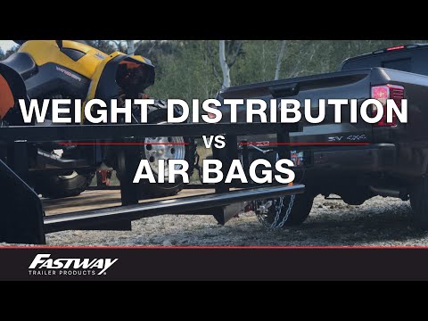

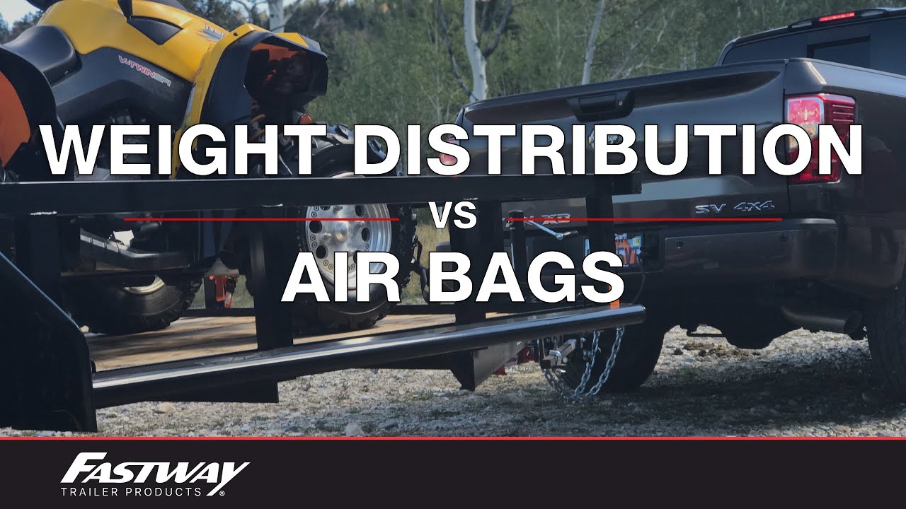

                  A point on the airbags. They will level the vehicle, but they dont distribute the tongue weight. in fact, they may actually increase it in some circumstances. There is some very interesting physics going on, but you can find some youtube videos done with the tow vehicle and the trailer on actual weight scales, and see how the different modifications impact the weight on each wheel. In the video i'm referencing, airing up the airbags actually increase the load on the rear axle, because the airbags are acting like a fulcrum for the lever of the back half of the truck. since it was lifting it higher with the bags, that translated to more weight on the rear end, and less on the front end. It was not a huge amount, but the point was explaining that airbags dont replace a WDH, they only help level.

                    in reference to my post above about airbags vs weight distribution hitch. Not that the WDH is pertinent to boat trailers, but the airbags are. In this video, they showed that leveling with airbags may actually increase weight on the rear axle and unloaded the front axle relative to no airbags. So they may only be good for making your tow vehicle appear less squatted, but maybe not actually helping. It also unloaded the trailer axles in their specific setup. Obviously these numbers and effects might be changed depending on the wheelbase of the truck, trailer, and positioning of the load. Point is, airbags aren’t always the answer for every setup. What would have been interesting is if they had leveled the truck with the WDH engaged.

                        I don't disagree, which is why I mentioned you can only draw a few conclusions about this specific setup, but possibly extrapolate to personal experience. I'll admit I was surprised that leveling with the bags would have unloaded the front axle more. But to your point, ever truck, trailer, load, and distribution is different, and wheelbase will play a role as well.

                          The reason the front axel would unload is you moved the height of the hitch ball when you added air to the air bags. Without the air bags, your hitch was, lets say, 5" off the pavement. When you added air to the air bags your hitch is now, lets say. 8" off the pavement. Get a bigger drop hitch to lower the tongue back to the original height, or level trailer height, and you will have equal weight on the axels, and you will not have the sag in the rear of the tow vehicle.
