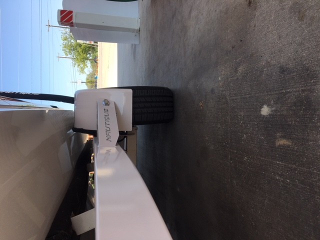

Anyone having tire wear issues with Boatmate and a G23? Both tires on front axle are cambered in and tires are wearing on inside pretty bad.. When trailer is empty they stand up right. Check the wheel bearings and all seems fair on the front axle (rear is another story). I just wonder if they trailer is heavy enough for the boat.. Any feedback is great thanks. NO the boat is not full of water. I do keep 500 lbs of lead in it but we haul about 5 miles to ramp on most trips. Sometimes we venture off an hour or two but usually its 5 mile ride. Could the extra 500 lbs be doing this?
Now the rear axle one hub is a touch lose but the Buddy cap say hybrid oil no need for service and you cant get to the axle nut without taking caps off.. I guess Ill let dealer look into this...
