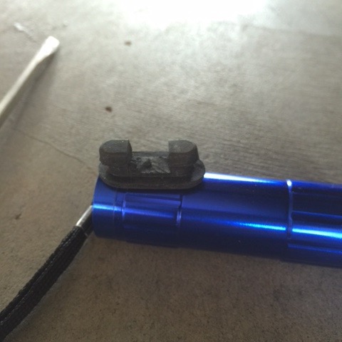

    Beach.. On my Dorsey with a drop, you take the rubber plugs (should be two) out of the bottom of the plate. Then you should be able to get a screw driver in there to roll those adjusters but I have to lay behind the axle and shine a flashlight in the front plug and then go in at about a 45 thru the rear plug with a narrow flat blade screwdriver to roll the adjuster. I had to modify my plate plugs so they are easier to get in and out.

      Here's the angle to get to the adjuster and the way I trimmed the plugs so they can be removed and replaced behind that drop spindle.

        Thanks! I was wondering how it was possible to adjust drum brakes with a drop axle. Sadly, I just looked through photos I took and confirmed that my brake assembly backing plates only have the forward plug. They must have been replacd at some point. Now I have to decide if I want to spend another $100 fixing my drum brakes, or spend $500 to convert to disc brakes.
