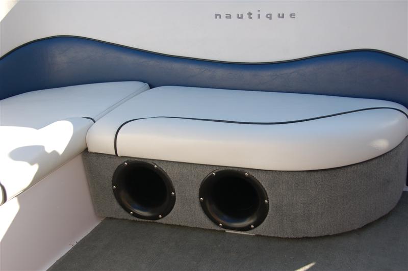

    yep... made it myself.
    http://www.planetnautique.com/index....t=211+seat+sub
    It's still kicking.
    I didn't think the 6.5s would last so I bought some Infinity 10's and planned to make a new box. After a few times out and after swapping the 12 at the drivers feet to the wetsounds subwoofer I realized that I am quite happy, so the 10's are still in the wrapper.
    I don't see any reason not to extend the seat all the way across the back of the boat. If I wanted to get into doing upholstery work I would make a new top too.

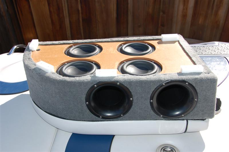

          what type of subs are the 6.5's, i thought only JL made subs that size?

            The design is borrowed from the Parts - Express Boogieman Subwoofer project.
            http://www.parts-express.com/project...man/index.html
            It's a stealthy little box that way outperforms most sealed 12" subwoofers. The placement in the back corner also helps transmit the subwoofer frequencies through the cabin of the boat.
            The four 140 watt subs wired in a series/parallel combination yield a 4 ohm load and can handle 500 watts in total. They are very lightweight using neodymium magnets, the wood is lightweight cabinet board, the whole package is not very heavy to move to gain access to the drainplug.
            Everybody that hears it is blown away by the amount of bass it produces.
