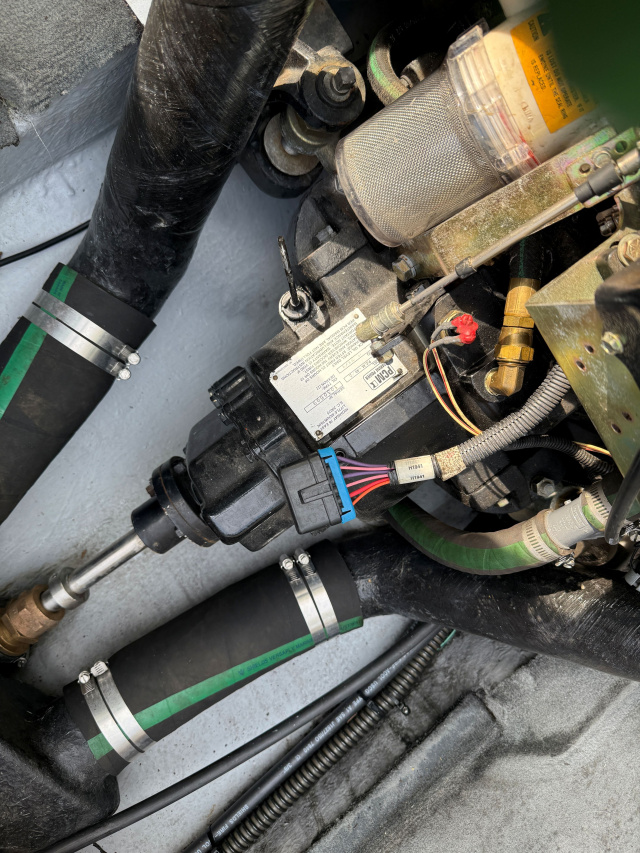

    I found a 6-pin connecter on the back of the engine that I think may have been the wiring for boats with those options?
    Can I tie into those wires to use the dash switches without tearing apart the dash?
    If not, has anyone wired in accessories to the (on-off-bilge) switch under the drivers feet?
    I'm uploading a pic of the connector I'm talking about.

    What you are asking about is certainly doable, but you need to know what switches you are connecting to. How much current they can support, and so on. I would definitely not tap into that 6-pin connector in the engine compartment, unless you know exactly what it is (your local dealer could probably tell you). A lot of the options you are mentioning, like underwater lights and tower lights were not available back in 2001 and the boats were not wired to support those options. "IF" that 6-pin connector was indeed for the ballast tank option, that it sounds like your boat is not equipped with from your post, it may be able to handle lights, but you need to know the numbers, i.e. required amperage of the lights you plan to install, wire gauge you are utilizing (especially if attempting to use factory wires and not add new wiring), length of the existing wire runs, plus whatever you plan to add, etc.). Some light brands require their own independent power supply wires, due to the high amount of current they can draw, while other less powerful options may be suitable to just tie into factory wires. Some lights only read a signal from the factory wires or switch (like a 12V on or off signal to turn the light on or off, which sounds like what you are hoping to do) and then also require brand new power runs to support the amount of current they draw.

      That connector on the back of the engine looks like the diagnostics connector.

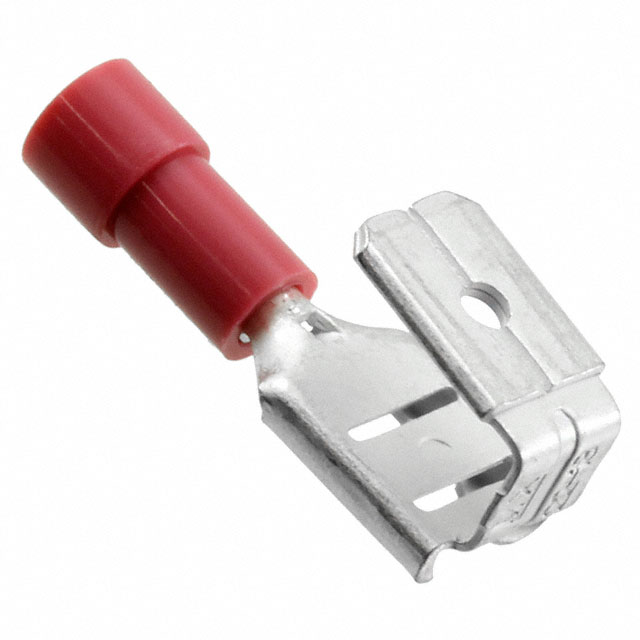

        For the tower anchor light, I would see if you can use use a spade jumper like the one below to tag on the existing anchor light circuit and run the new circuit to the tower.

        If this is a factory installed tower, many were pre-wired and may already have a anchor light circuit wired into the tower. If this is the case you could simply complete the circuit from the newly added jumper to the wire in the tower going to the added tower anchor light. While this is not at all a requirement, if you're concerned about current draw you may want to consider retrofitting the navigation bulbs with LEDs, which would greatly reduce power draw. You can get marine rated replacement LEDs here...
