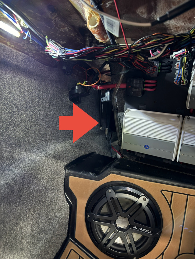

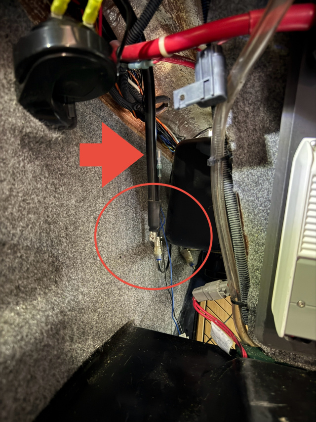

                      I’m having a similar issue with my 2016 G21 (Factory Polk system, head unit and amps wont power on). I noticed a dangling black wire next to the amps in the cuddy area. I've checked the battery connections and fuses so far and all seems ok. The amp connections look ok and I see another black ground wire is already connected to the amps. I'm not sure what this dangling black wire was connected to?

                        Look like an antenna wire to me.

                          The wire is roughly 1/2” thick. I’m fairly positive it is a ground wire. I do see a potential empty space in the ground connection distribution in the second photo (upper right).

                            That's why I think it looks like an antenna wire. They are a coax and they are thick like that. The only ground wire in a boat that is that large is the ground wire between the battery and the starter.

                              Do you have any other suggestions how to verify power issue to amp and stereo assuming that’s an antenna wire and not one of the disconnected “ground” wires?
