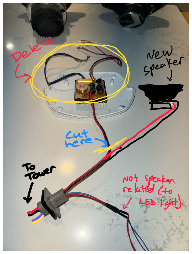

        Thanks y’all. I think it was MLA who helped me out in an audio FB group where I also posted. I’m uploading my sketch of the solution.
          cut it at the circuit board/cross over, no need to shorten your wire length and have to do a crimp or solder joint

            distinguishedmotorsport​ - that's what I did. Thanks. I don't know why I sketched it like that.
