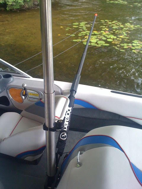

      Getting some racks up is another good reason to go tower. Since my post, I have seen a couple pictures with boom and fly highs mounted together.
