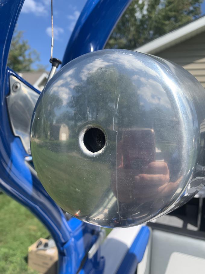

        How did you remove the speaker out of the rotating can? I would like to replace or re-cone but can’t figure out how to remove. Thanks

          You have to remove the screw from the backside of the can

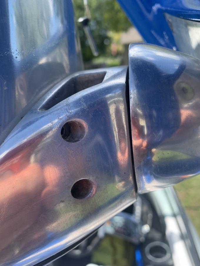

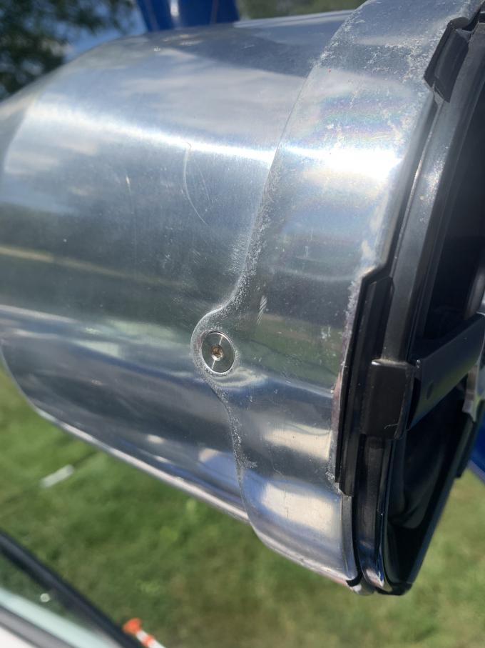

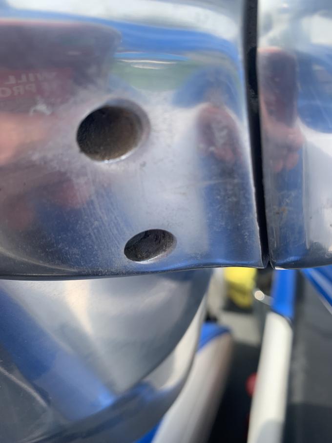

            Thanks for the response, but I’m still struggling.
            I removed the back screw but I still cannot remove the speaker, the Phillips screws on the speaker face turn but do not come out. I tried prying, but it felt like I was going to break the plastic. What am I missing.

              Give me a few days and I will find out for you. My son took ours apart. He is at school and his phone just broke so I can't ask him. I'll get back to you in a few days. I think after you remove the back screw and the screw on the side the whole assembly slides out. I'll confirm.

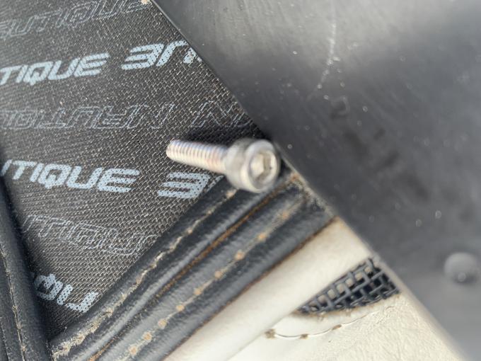

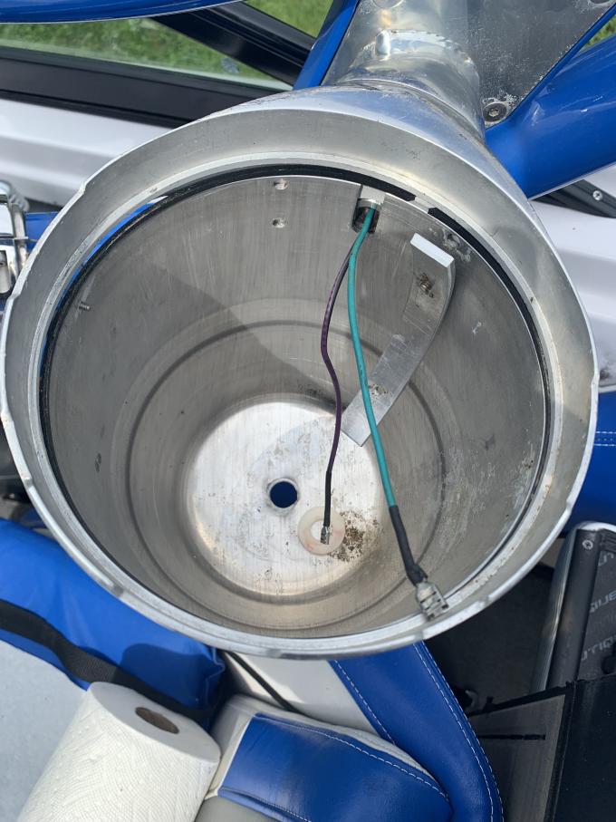

                  Finally got it, you were right I had to take the side Allen screws out. Thanks,
