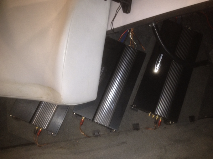

                      Here’s how mine were mounted on my 05. Please excuse the super dirty upholstery. That was taken right before I learned about LA’s Totally Awesome cleaner.
