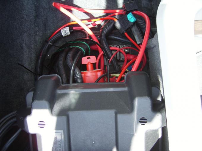

Lastly, I've bought several used boats that had "professionally installed" sound systems installed by local shops. By and large the quality of the materials used (crimp connectors, wire, cables, etc.) has been sub par, has not been marine rated and in some cases near dangerous. Things like direct runs to the battery instead of bus bars, car audio fuses instead of breakers, wiring not properly routed or supported are far too common from budget shops employing high school kids as installers. Finding a good shop that does proper marine rated installations with professional installers is difficult and these shops that do the work correctly tend to be pricey.Last edited by bturner; 09-11-2019, 12:15 PM.

Edit - Got to thinking about this last night and found a picture of the advertised $2000 "Professional" stereo installation from my last boat. It included a Pioneer car amp, 4 - Wet Sounds tower speakers and a battery power switch. Below is a picture of the battery end of the professional instillation. What you can't see is that they mounted the battery switch with aluminum wood screws to the battery box that had started to dig into the battery. After tearing out all the wiring I also discovered that all 4 speakers were tied to the tower lighting wiring and were all on a bridged single channel of the amp.

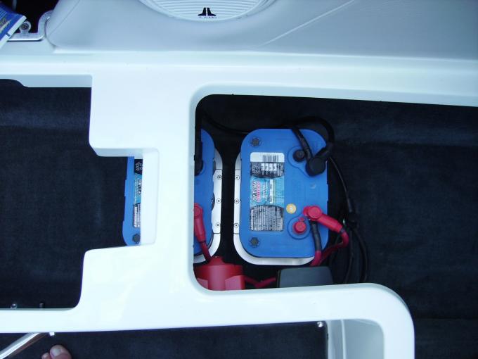

The second picture is the "after" picture of my dual battery set up in the same boat.Last edited by bturner; 09-17-2019, 06:32 AM.
That first picture is criminal! Lol. That second picture is very nice, great work, that how it should be. Even got the nice battery tie downs too. Every screw on a boat should be stainless with very few exceptions. Black steel wood screws have no place here.Originally posted by bturner View PostPreach brother, I hear you.

The funny part is that the OP was very proud of the installation, said a friend owned the shop that did the work. Just bit my tongue, closed the deal and put it on the list of corrections that would need to be completed. Everything the PO touched was jaked. I was lucky to pick the boat up from him after only 2 seasons.
