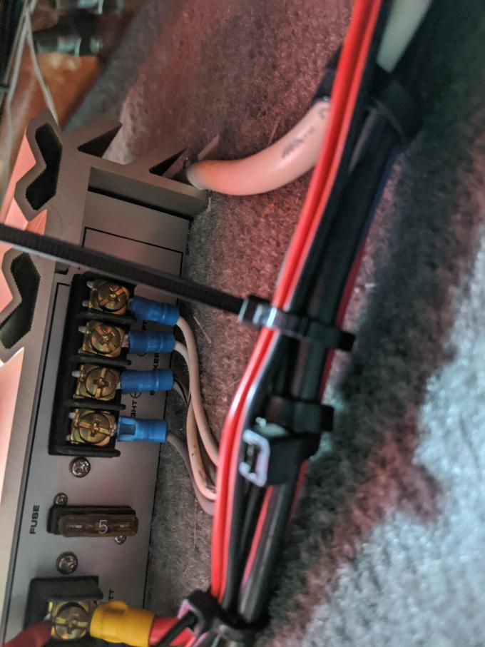

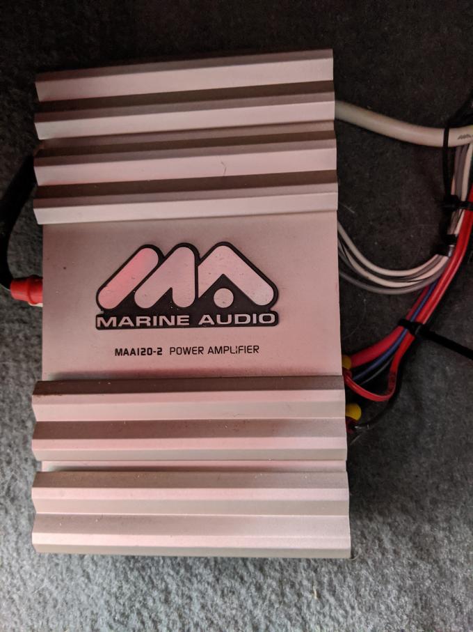

        OK. Did some real poking around and have decent sense why stuff sucks. Here's what I seem to have.
        1) Amp that is installed appears to only be driving two of the four speakers. How did I reach the conclusion? Basically from only seeing two RCA cables going into the amp and 4 speaker wires connected. The head unit fader does work. Sooo...that says to me head unit is driving two, amp is driving 2. I have no idea what two.
        2) The amp itself is...deficient. I can't find anything online about the amp (pictured) but I think the 5 amp fuse tells you what you need to know - very low power- maybe 20 per channel max with RMS power even lower. I will give whom ever installed the amp kudos for a really nice wiring job! Looks like a shop did it.
        Sooooo....I think a 50 or 60 wpc 4 channel amp should be a good starting point.
        Current amp
        Connections to current amp

            • MLA
              • Dec 2009
              • 1312
              • Lake Wylie NC Area
              #21
              Its a Marine Audio brand amp. They were pretty much an OEM supplier, not aftermarket retail. So this is likely why the lack of info found. Though the name lives on, the original family owned Marine Audio company was bought up by ASA about 6 or so years ago.

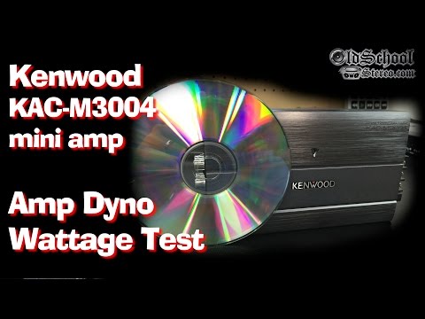

                      OK. The little Kenwood KAC-M3004 looks interesting and price effective @ $125
                      Kenwood
                      https://www.amazon.com/Kenwood-KAC-M...id=1584461716& amp;sr=8-1
                      Youtube test - this is pretty funny to watch actually

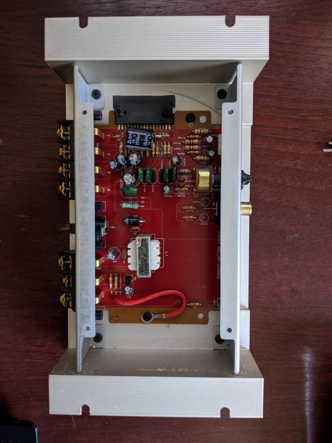

                          I decided to open up the Marine Audio amp to see what's inside. Pretty basic stuff....however the thing is built like a tank. I swear the metal for the baseplate is thick enough to stop a bullet!
                          If there any preservationists out there, I'd be happy to donate this; just pay the shipping.
                          Click image for larger version  Name:	IMG_20200322_113306(1).jpg Views:	0 Size:	64.8 KB ID:	603196Click image for larger version  Name:	IMG_20200322_113249.jpg Views:	0 Size:	78.6 KB ID:	603197

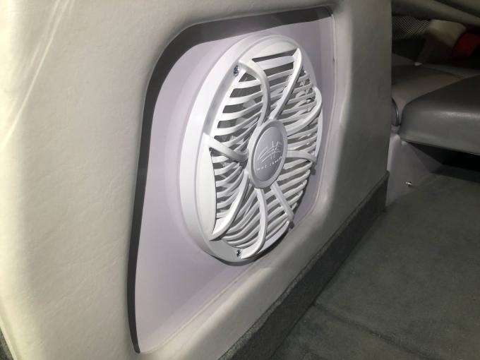

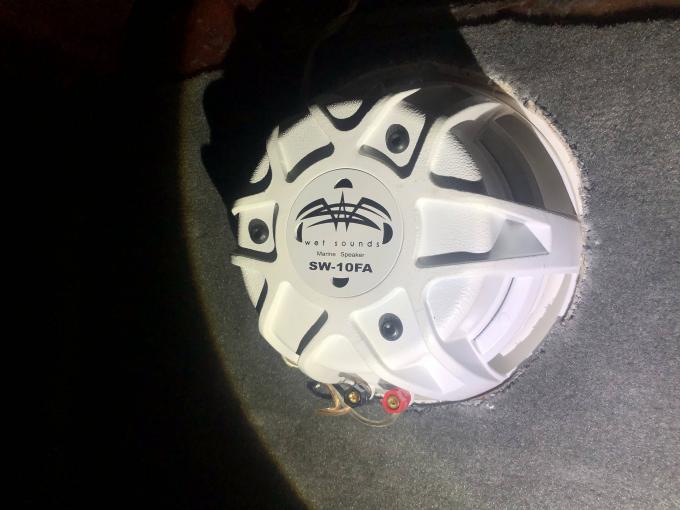

                            Had some questions around the sub install. Here are a couple of pictures.
                            I used a dremel to cut through the fiberglass after removing the vinyl piece. I then removed the mesh pocket panel. I removed the mesh pocket and the sub fit perfectly in there and you can put the panel back on, I taped the whole area that I would be cutting with painters tape first.
                            It is plenty sturdy there and I don't get any rattling. I was going to reinforce it but it was fine. If I remember correctly, the top was really thick fiberglass for the hole and the bottom was thinner.

                              That looks nice. Out of curiosity...did you do the 2 or 4 ohm sub. And why?
                              Bellevue WA
                              • dski
                                • 73
                                • Utah
                                • 2004 Nautique 206 2007 Nautique 236
                                #30
                                2ohm. I tried both the 4 and 2 and I got more response from the 2ohm
