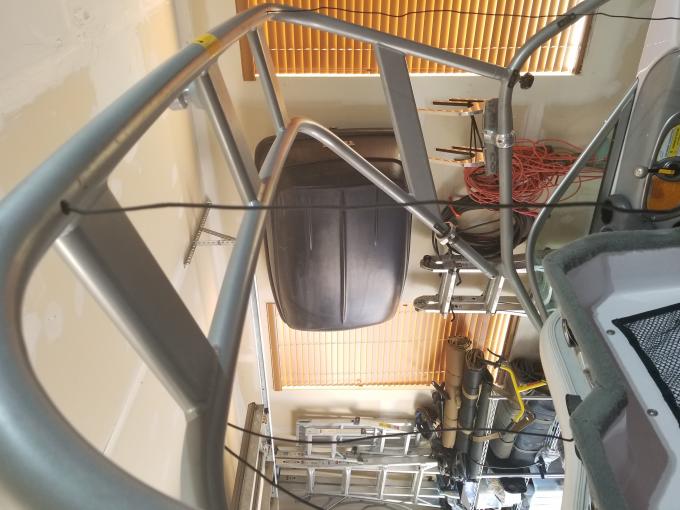

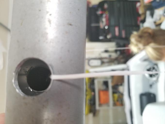

    First order of business.... Wire up the tower. I used a step drill bit and drill bit extenders to drill from the back of the tower through the tube, cross bar and then into the tube in the front without having the bit exit the front. Holes under the tower that would go directing down into the speakers.
    I then used dental floss and a vacuum to thread from spot to spot and then tied that to paracord. Then used the paracord to thread the speaker wire. I used 14 gauge wire.
    Can't figure out how to rotate the photos.
    Holes for threading wire
    Only 1 extra hole was needed in the back of the tower. Here is looking through the hole (the two holes that you see are the tube and then the cross brace. This is the dental floss used to make the bends. Be patient and cover the other holes for best suction while feeding it through.
    Looking from back of tower through to front.

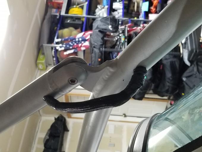

    Drilled hole through base of leg and then to the bottom section of the tower. The cord will then run right into the boat. The black plate that sits under the tower to protect the boat has a punch out that must be removed. Just unbolt the tower, lift slightly and remove the plate and remove the punch out and reinstall. You may just be able to do this from below, but I didn't know what I was up against so I unbolted the leg.
    Cord from top part of tower to bottom

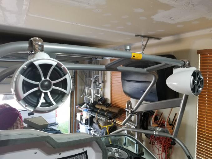

    All in all, really happy. Finished product!
    Speakers

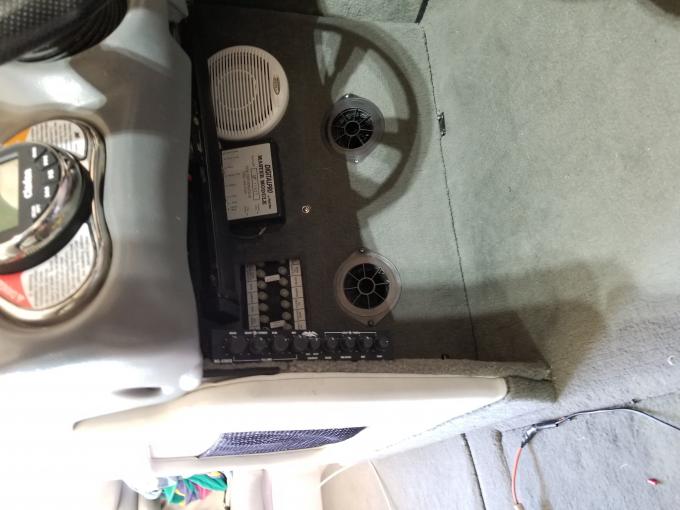

    I went with the side mount since the under the dash seemed to be possibly hitting my knees and boy (6' 3" and 6'5")
    Still need to clean up and bundle up cords and such but sounds really good. Also thinking of moving from the kicker 10" tube sub that I have in the doghouse to a 10" wetsounds infinite baffle and have it exposed in the walk through.
    Still need to change out the cabin speakers but that is for another day.
    Happy with the result!

      I am using the Clarion GR10BT head unit where the remote key pad is by the steering wheel. I had to dremel out a little fiberglass behind it but was really easy. I replaced the cabin with JL audio. Very happy with both.

            I wanted to have all the controls by the driver. I removed the clarion in the glove box and put the 'blank' in. (Also from Nautiqueparts) I wanted to go this route because the remote didn't allow you to change songs and I didn't like the remote navigation. Volume was slow to bring up and down in between sets. The Clarion allows me to control forward/back and just hit pause when I am talking to the skier.
            When I started the project, I was just going to use the clarion in conjunction with the amp for the cabin. Once I decided to add tower speakers and the wetsounds, there really wasn't a need for the Clarion since you can just bluetooth to the Wetsounds. That said, as mentioned before, I like navigating the songs and having the volume and pause button right by my hand. Small benefit - it is nice to still have the FM/AM radio from time to time. (College football!)

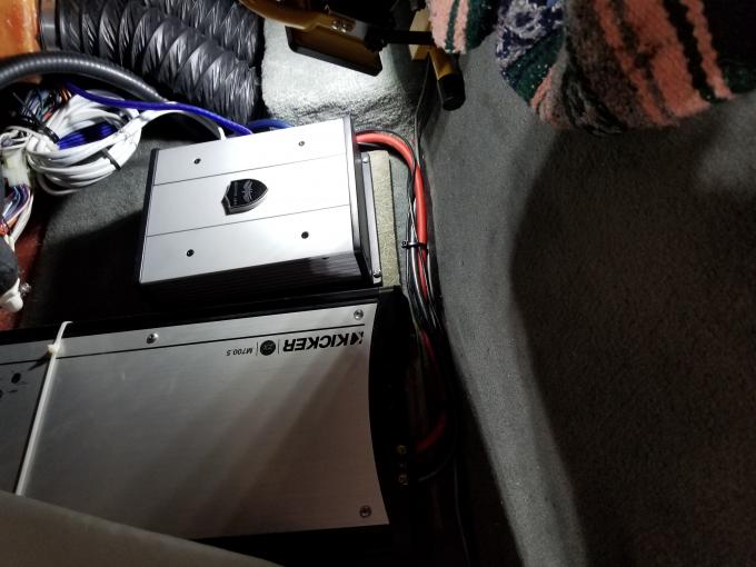

            Yes, there is a cable way from the dog house to underneath the kick panel. Once I used a fish tape, I was able to move them back and forth. My amps are mounted under the dog house (Passenger side storage)
            I'll try and take a picture tonight where that is. You can also route through the bow and back into the driver kickpanel.
            If you stay with the factory, just adding an amp to the subwoofer and cabin speakers makes a big difference. The picture I included are the two amps. The big one is a 5 channel amp that does the cabin and the sub. The small one is for the tower. I have since moved to a newer version of the kicker amp died after 8 years of use.

                    I have the KXMA800.5 amp . Been really happy with it and gives me one amp for the cabin and the sub. I originally had a sub in the dog house but ended up mounting an infinite baffle sub in the walkway.
