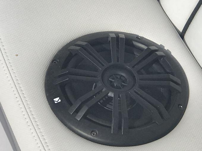

    These are in the bow. I don't know what they are. Does anyone know?
    Click image for larger version  Name:	IMG_4560.jpg Views:	0 Size:	39.9 KB ID:	587508

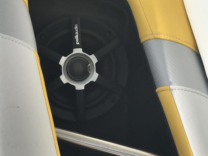

    I guess these are the stock 6.5" speakers. These are in the cabin.

    The bow speakers are a Kicker Marine, Look to be the OEM grade Km601 or KM604. Quality built, but not their best sounding speaker. Id bet they are driven off the head unit.

          Id bet that the bow speakers were either replaced years later or not there to begin with, as the reason for those Kickers now.

                    Thats a great speaker and will be a good match with the amp. They come with a white and charcoal grill, You could use the charcoal grill for the main cabin and the white for the bow. If you wanted to add some bling, get the model with an "L" on the end for LEDs.
                    IIRC, those polks have an external cross over that needs to be removed/bypassed when you wire up the new speakers.
