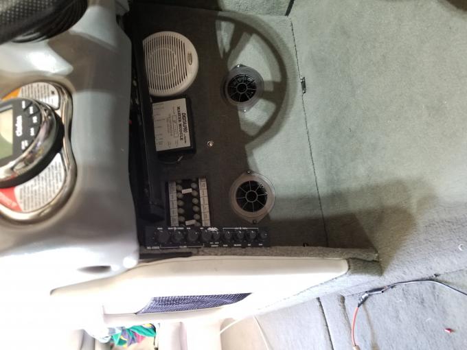

    I am updating the stereo (again) on the 206. Throwing some tower speakers on and installing a Wet Sounds 420 for the zone control. Any ideas on where to mount where accessible and looks great? Struggling on a good location that looks clean.

    I made some brackets to mount mine under the dash on the left of the steering wheel.. It's just under the dash so not too low, but can be close to your knee sometimes. It's easy to reach which was my main purpose for installing there. This is on an 03 SANTE, but should be the same dash. Sorry no pics...

      Mine is mounted left of the steering wheel and set back some, I mounted a piece of black starboard and mounted the brackets to it. I really like the control that it gives you.

          The way I routed it, I needed about 11 feet to make it. I can tell you the 9 footers were short and had to rerun them. Here is where I ended up positioning my 420. My hand goes right to the first couple of dials (Volume, boat/tower, sub) which are the ones I expect needing the most.
          Could not be happier with the control. I can blast the surfers and back of the boat with the towers while talking to my wife sitting next to me. Kids happy, dad happy.
