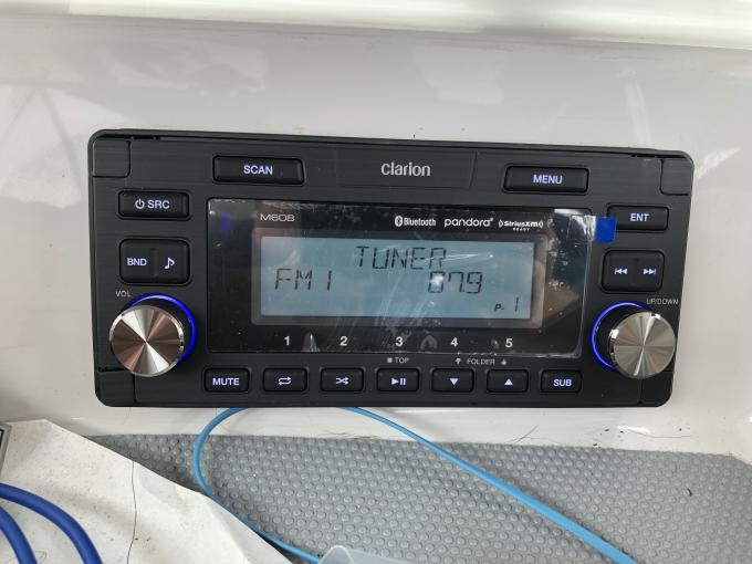

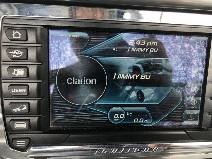

                  Just installed it. Plug and play. Works great with linc 2.0 and rear remote. Bluetooth shows song and artist, etc on all 3 devices. Only decision I have is sound setup. You can adjust all speakers (inside boat and tower) together or as 2 separate zones. For now I have them all treated equal. May need to change that setting. Still need to drill a hole for the Sirius XM antenna.
