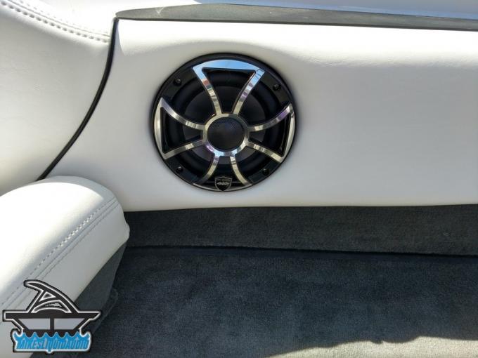

        Unless the foam is very thick, like 2"+, I dont feel a spacer is needed if you prep the foam and vinyl to all the speaker to recess. For thick foam, you would want the space behind the speaker so to not compress/stretch the vinyl too much.
        Redoing the vinyl is a perfect time to make the speaker conversion

          So are you saying if the skin is installed a certain way, the speaker can be mounted without the plastic ring?
          • MLA
            • Dec 2009
            • 1312
            • Lake Wylie NC Area
            If you are starting with fresh vinyl and the foam is not too thick, yes, not spacer needed Click image for larger version
