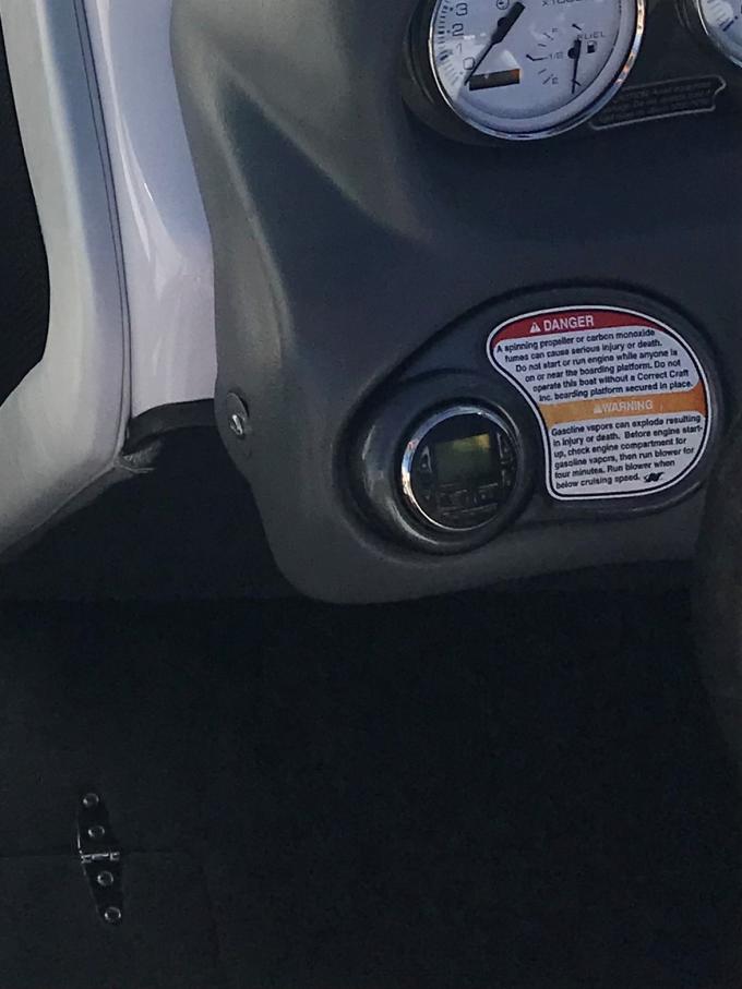

Has anyone ever upgraded there 210 to be Bluetooth capable? I’m thinkin about just bypassing the head unit completely and going Bluetooth only. I’d like to find a unit that fit in the dash mold were the clarion unit is now but don’t know what would fit or if its that simple. ( pic below)
I don't know of any small round BT units.
I would just replace the head unit, which is probably in the glove box. All controls can be done on the phone, so there is no need to have the volume at your fingertips.
If there is an Aux port on the current head unit, you can attach that to a bluetooth unit which would work pretty sweet, but I am not sure that most stereos had Aux inputs back then. It would even allow you to continue to use your current remote setup if you like it.

Yea, you'll need a new headunit. Just find a good one that has Bluetooth. Might as well also make sure it's Sirius/XM ready as well in case you ever want to go in that direction.

Found this thread about updating the oval faceplate. I believe this newer style faceplate allows for integration with a separate remote if you find the right stereo.
https://www.planetnautique.com/vb5/f...al-dash-remote

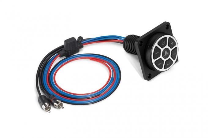

I just looked that up on JL-Audio's website. I suppose it would work, but you're giving up a lot of functionality with this. You have no ability to balance/fade. The fade would be the big problem. It's pretty nice to be able to adjust that between the tower and cabin. You also have no tone controls (Bass, Mid, Treble) unless you can change those on your phone.Originally posted by Wreckem04 View Postwhat if i dont want to us the head unit anymore. and add in something like this (below) and run it straight to the Amp? the lakes we visit have no radio signal so we run off 100% bluetooth.
Personally, I'd get a decent head unit that supports a mounted control and put that in that hole.
