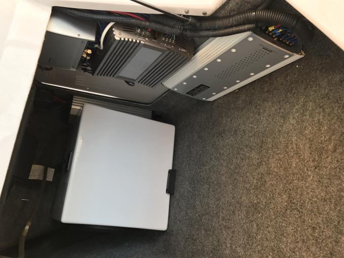

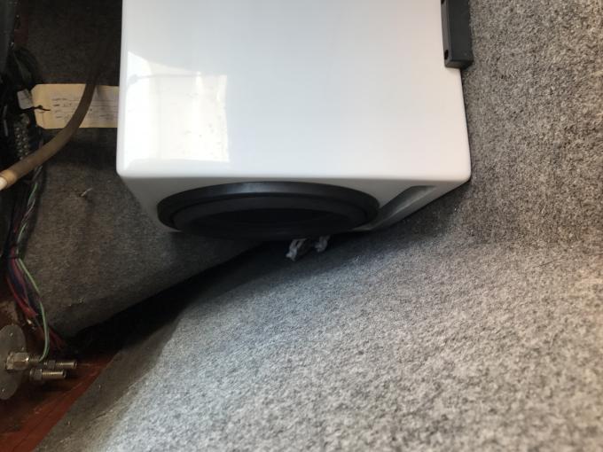

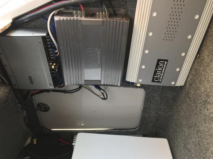

      here's what i got.
      what i did was take a 12' altrend (spelling?) box from amazon, cut an extra panel so the whole box was flush, ripped off all the carpet, sanded/leveled it, then had my gel coat guy spray the whole box in silver cloud.
      matched really well, and gave me a 12" vented instead of the factory 10" sealed enclosure.
      woofer was a 12" sundown type E sub, dual 2 ohm voice coil wired to 4 ohms for the stock sub. originally had it on a JL a1600 mono sub amp that was putting out 500 watts RMS at 4 ohms and it was considerably better than the stock set up.

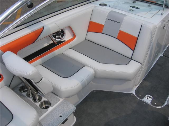

                        This is the area/seat I'm talking about (small flip up seat under the removable seat back), I would then install a grill/vent in the seat base, thoughts?

                          your interior is pretty similar to my old boats. always liked the orange.
                          something about that placement to note:
                          the area has tubes that support that hold the reversible seat back bars/pins. remove the access panel and you will see.
                          i looked into placing JL 8" woofers underneath the latch for the removable spotter seat but i didn't think they would fit easily there.

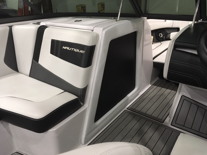

                            I had to be a little resourceful to make it happen, but cutting out the opening was a must if I wanted the subs to sound right.
