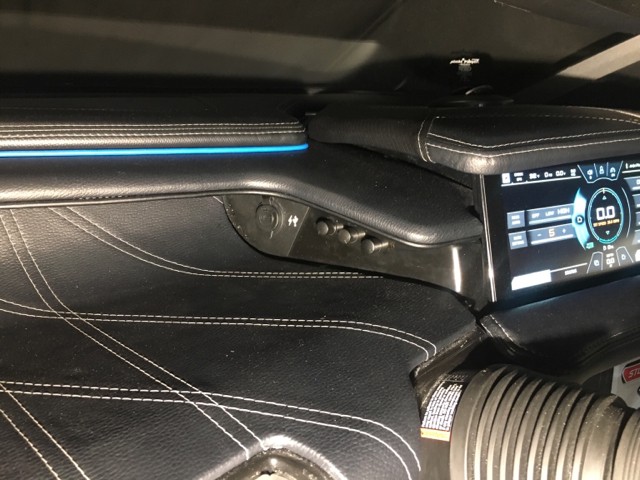

    This is not my boat but it is the exact same location I place my TWO volumn control knobs ( one knob for cabin and one knob for tower) . I like my knobs at eye level because it is easier to adjust on the fly vs fumbling with them at the knee cap level in the lower dash area. Others will disagree with my placement but at eye level it is much easier and makes for a clear and more finshed look. Everyone ask why this member has a third knob and I think it may control the Sub speaker separately. You can buy these JL Audio volumn control knobs off of Amazon for about $25.00 each, and they plug into the back of each amp with a phone jack input.
    These knobs are the most used features on audio system but far. I love them and use them all the time. I very useful upgrade IMHO.

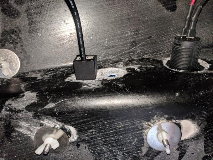

        I followed GMLIII and added 2 knobs to separate the tower and cabin speakers. Very simple install. Here is what mine looks like.
        The hardest part is thinning out the fiberglass so the knobs can be secured from the front side. Here is what it looks like on the backside.
        Here is a link to full size image
        The wire included with the knobs is long enough to run through the bow from the helm to the amps. Takes a little work to find places to zip tie the wires but other than that pretty easy.

            Thanks for the pictures. That is a great setup. Looks factory. I like that idea. Those knobs look to be on a newer G than mine. I'm assuming the 2015 has that same space there to mount the knobs? I won't be able to look until this weekend.

              Thanks for the pictures. That is a great setup. Looks factory. I like that idea. Those knobs look to be on a newer G than mine. I'm assuming the 2015 has that same space there to mount the knobs? I won't be able to look until next week.

                Your G 2015 dash wil be set up a bit different but I think there will still be a flat fiberglass area similar to my knob placment area on your G
