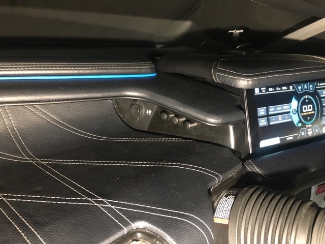

        I ran 3 remote controls from amps and put them in glove box next to steering wheel Click image for larger version
            Very clean looking

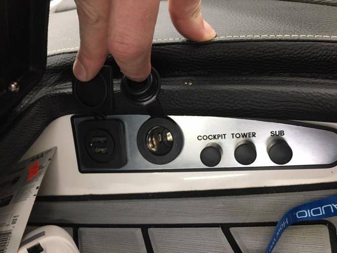

              Here is my zone control knob placment set up .
              https://www.amazon.com/JL-Audio-HD-R...o+zone+control
