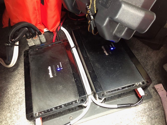

    Have 4 horn tower speakers on my 2014 210. Just noticed that only two are working. I'm pretty good at electrical but haven't really messed with audio that much. Any idea where to start? Pic of Amps below. I also struggle from hissing speakers like many others but decide not to go down that wild goose chase

    The amp on the left looks like your 4 channel that is for the tower. The one on the right looks like a 1000.1 which would be for your sub. Weird that just 2 dont work. I would pop the back of the can off of the speakers that dont work and note the color wires. Then find them out of the amp and make sure they are tight. You could then swap them with one that works to test. It is likely that they are blown. I cooked mine the first year of my 2015 g21. I swapped them with these. https://wetsounds.com/pages/products/REV696RS. They where way louder and can handle more power.

      it would actually be a 5 chnl, not a mono, for the woofer AND in-boats.
      Non the less, polk 4 chnl does drive the tower. Are the two speakers out on the same side or one on each side of the tower?
      Could be balance in the head unit. RCA connection either at the head or the amp, bad amp. Could be two blown speakers, bad connections at the pods, pinched wires in the tower. A simple volt/ohm meter can be a huge asset.

        Uh, im pretty sure if its a PA D1000.1 which is what it looks like than its a single channel sub amp. Could be wrong though. I would be interested in more info if I am.

          The setup looks very OEM, especially with the 3 deutsch style connectors that carry the tower, in-boat, woofer and turn-on circuits. ive not know of a correct craft of that generation, to have an OEM woofer without an amp for the in-boats. Ive also never seen CC to use the PA D1000.1.
          The dimensions of the D5000.5 and D1000.1 are nearly identical, so they do look similar against the smaller D4000.4

            Did check and yes it’s a D50005.5, hoping to dig into the issue more tonight

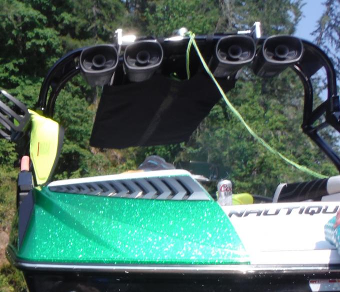

                Were you able to install these inside the same factory enclosures? Have any pics? Im looking to replace my roswell horn drivers on my tower as they sound terrible.

                  Yes they fit without the grill.... Not the quality photo
