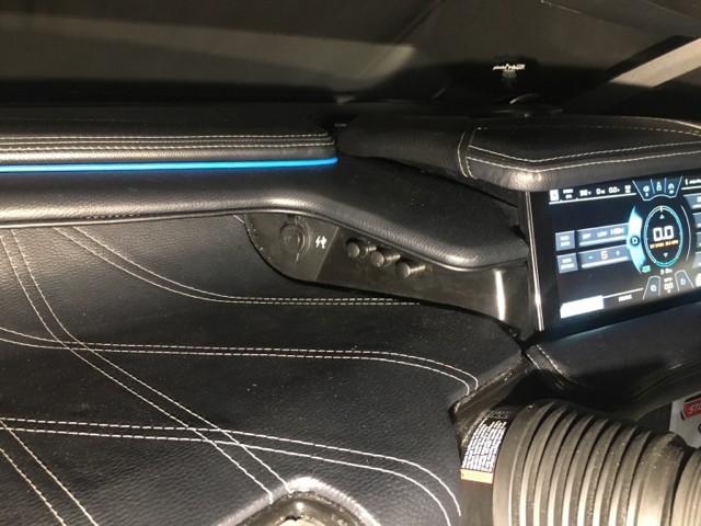

    You will need to purchase 2 of these knobs. One to control cabin speakers and one to control tower speakers. Here are the knob placements from another forum member on his G23. In his situation the 3rd knob controlled the sub speaker. Problem if you have 3 knobs is that you only have 2 input ports into your amps for these zone controls. You should be fine if you set up one knob for cabin/bow speakers and one knob for tower, that is how I have mine set up.
    https://www.amazon.com/JL-Audio-HD-R...o+zone+control
    Click image for larger version  Name:	image_39906.jpg Views:	1 Size:	80.4 KB ID:	562336

      You will need to purchase 2 of these knobs. One to control cabin speakers and one to control tower speakers. Here are my knob placments on my G23.
      Thanks for the link and picture!. What you using the third knob for?

                GMLIII how did you run your wire from the knobs to the amps? I was thinking under the floor but the more I look at it running under the bow seats would be easiest, as I do not see an easy way to access under the floor in the observation seat area.
                Also, what did you do to get the posts to stick out far enough? The fiberglass is too thick to be installed using the method described on the box.

                  I ran it under the bow seats on my 230. We use them every time we're on the boat.
                    I dont know. I did not want to drill through my fiberglass dash therefore I paid my dealer to install the knobs, run wires to amps and add an addtional 2 tower speakers. Charged me $300.00 for labor. As Neirbot stated above, I use mine all the time. One of best accessories I added to my boat other than maybe the strapless board racks

                        #26
                        Not sure if you tackled this but you can use a dreamer or similar to thin out the backside of where the knob will mount. This will allow for it to stick further out once installed.
