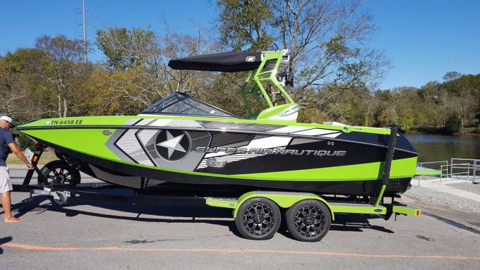

    Click image for larger version  Name:	20171026_141049.jpg Views:	1 Size:	59.7 KB ID:	549369

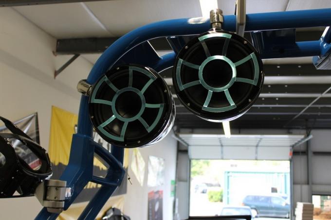

        I dont think you will get a rev-10 on the tube, with a rev-10 in the outer OEM location. Click image for larger version
            I have a few questions on this:
            1. Your picture, given your post-shows the innermost Rev 10 in a spot that differs from the stock outer speaker mount? (I ask-because it looks close to where the stock outer speaker is-I think)
            2. Is there a discernible difference in the Rev 10s and stock, by only changing the speakers? (I have the upgraded 2017 system with the 2-12"s, etc.)
              As much as I'd like to consider doing this, as it creates more space "down the middle" of the boat, I only would do so if there is a large difference in sound AND I'm not horrified by what I find when I remove the stock clamps (marks, chipping, etc) - I will be grabbing for my chest if I have any of these... Thanks.
              RTD-G23 . I know you purchased the strapless Nautique board racks and based on the picture above there is no way you could swing the board racks in with boards on them because they would hit the speakers. In this particular set up the racks are the traditional strap model.
                  1) The inner speaker is placed as far out as the outer speaker would allow it to be. Its mounted to the tube between the inner and outer factory mounts. This gave us the widest path above the floor. You could mount the inner speaker on the inner factory mounts, but you wont get the inner speaker on the outer mounts
                  2) yes. A 10" speaker is about 50% more surface area. That equals more output and deeper mid-bass, even is the amp wattage stays the same. Driving the Rev-10 more to its potential, the difference is even more noticeable.
