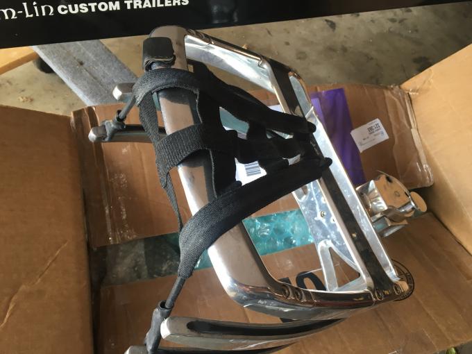

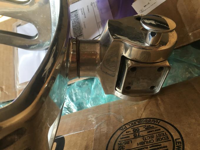

    Just bought a pair of used Nautique board racks for my 2001 SAN with FCT ... is there an adapter out there or will i have to fab something? I saw that roswell has some level adapter thing but I would still need a clamp for the tubing.

    I don't think there are any "bolt-on" adapters, but check Roswell. I had "frankenstined" some of those on my previous boat, had build a custom set of clamps, no easy feat! If you have access to a machine shop, the best option maybe to get an angled block of aluminum machined to bolt onto the tower so you can bolt the swivels to the block.See if you can find a late model Nautique, 2011 and newer to check out the tower for how those swivels are bolted.

      I'm doing the exact same thing, same racks. Roswell has the clamps and the level adaptor. When I called Roswell they recommended I purchase the 3" clamps verse the universal clamp, claiming that the racks that you and I have are heavy and the 3" clamps would provide much better support.
