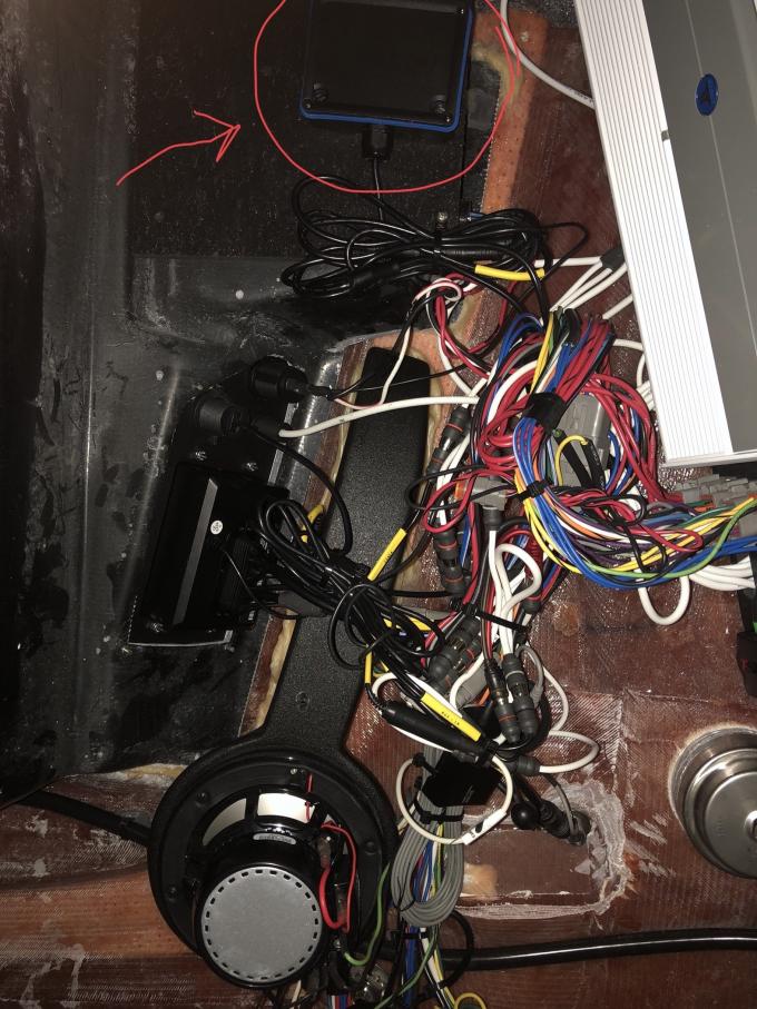

    OK, I got mine done, but may regret doing so. My boat was at the dealer from Tuesday through Friday. When I got it home yesterday, and had it on the lift with the boat off-I could hear "white noise" coming from my speakers. I called the dealer, and the service writer thinks the amp gains are turned up too high. My retort is that I have a 2018 G23 that was completed in October/delivered after Thanksgiving sitting less than 50 feet away from my boat. I'll look at the gain settings on it; mine should be the same-and why wouldn't mine be set up identically to a 2018 from "jump street"? Secondly, I looked under the dash, and it looked like a bird's nest. Again, I am admittedly an "exacting SOB"; I want it identical to the 2018 that was delivered next door. I'm going to take a picture of both boats' under dash areas after sunrise. I have stains in my Sea Deck that I can't lift from this procedure. Not happy. Problem is, I'm not taking it back to the dealer again, like ever, that is unless I take it back and give the boat back to them. This retrofit should not have been that involved. My 2017 that was completed in June (toward the end of the model year production) is no different from a 2018 with the exception of the taller tower, RBG lighting, and some other small cosmetic items like the new lifting rings. This should have basically been "plug and play". I think I have a problem that is going to involve a fight. I am sick about this - - sick.
    Below are under dash pictures of the 2018 next door and my 2017. Mine has a circled item that is a JL unit that allows for a wireless remote. Other than that, they should be the same, IMHO...

        Click image for larger version  Name:	83645191-ED0D-4E5A-BF71-6F4EBFC3E39D.jpeg Views:	1 Size:	113.3 KB ID:	549225Mine (retrofitted 2017)

          In defense of Nautique/the dealer, I think the Polk head unit was a 2 OHM unit, the JLL, a 4 OHM.
                            head units don't have impedance like a speakers.
                            i believe you are think of line voltage on the RCA preouts. the signal line voltage could be different, and likely is. ie 2 v vs 4 volts. But i wouldn't trust the local dealer to install an amp or stereo accessory personally.
                            also, check grounds for whine.

                                The dirty ground issue is one I suspect as well...
