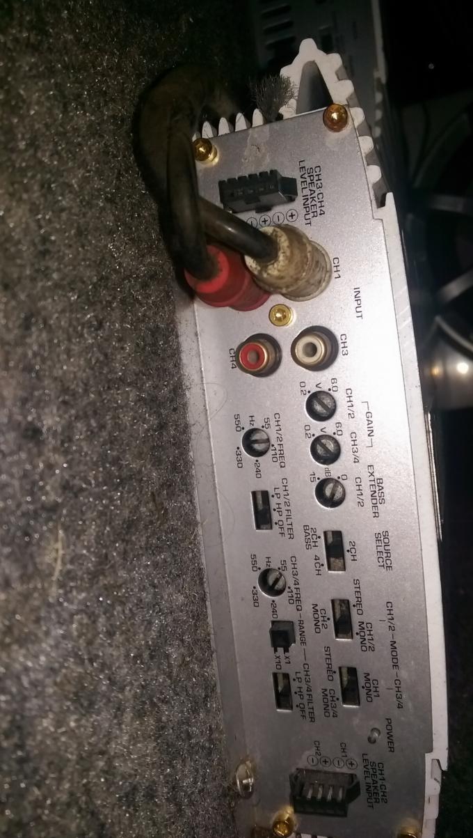

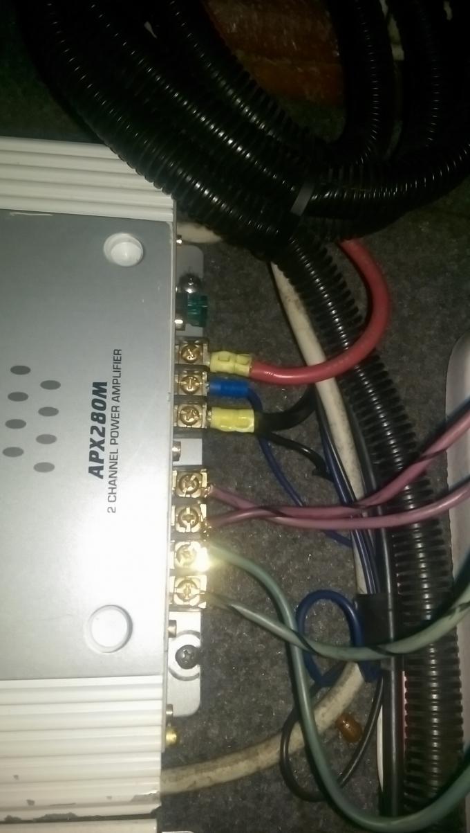

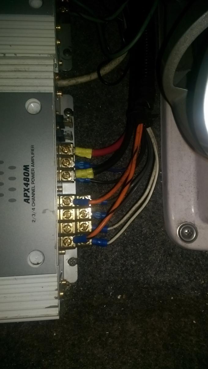

    The previous owner of my 2005 SV211 said the tower speakers were blown and needed replaced. After troubleshooting, I discovered my APX280 2-channel amp was bad and the speakers were fine. I replaced the amp (same model) and now the tower speakers work, but now the 4-channel amp (APX480) has the blue flashing light and the cabin speakers don't work. However, if I disconnect the 2-channel, the 4-channel and goes back to working. Clearly there are wires or settings crossed somewhere, but I haven't a clue where to start. Anyone encounter anything like this previously? I attached pictures of the wiring into the amps as reference. I don't have pictures of the amp settings, but can attach those this evening if helpful.

              You sure you have the subwoofer (orange wires) in the right position? looking at the amp set up on the APX480, the wiring looks funny. granted, its been a while since i looked one. I have hit the fault blue light you are describing when running a 2 ohm load on the sub channel. due to how the amp is bridged, the APX480 is ONLY 4 ohms and up stable on the sub channel.

                No, I'm not sure. It's how it was wired when I bought it. At that time it worked fine along with the cabin speakers. The APX280 did not, so I replaced it. Now I have the reverse problem. Admittedly, I know nothing about Amp and sub stereo systems.

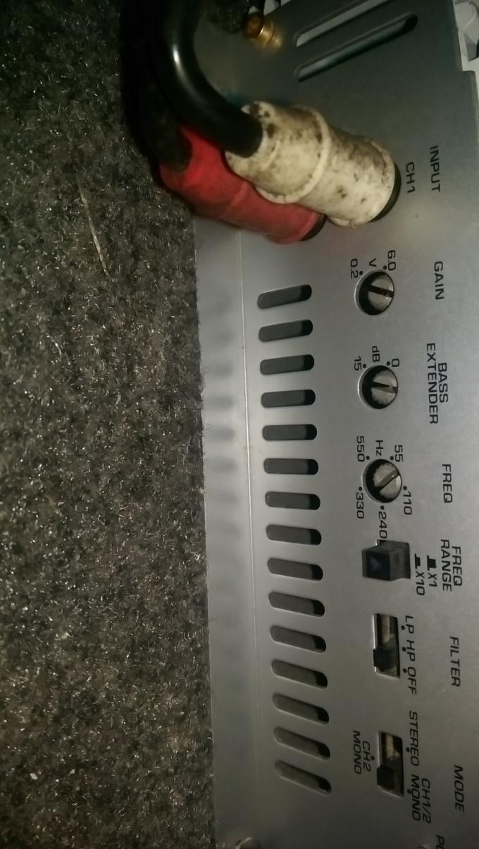

                Below are the pics of the settings on both amps. Hopefully it's as simple as the wrong setting.
                Beacons - Your tip about the low pass filter fixed the flashing light on the Amp, but no audio is coming from the cabin speakers. I can hear the sub though. Click image for larger version
