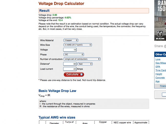

              I wonder if you really have a problem. I think what matters is on average if you are at 12.5V system volts while running, then your batteries won't charge for your next outing. If the batteries back stop your alternator for a bit here and there things should be fine. Note, I did a quick calculation (see attached) and see significant voltage drop, if your amplifiers are drawing 40 amps (and based on RMS watts, it is possibly they are drawing significantly more). I guessed at length of wires, but note you have to use total length of 12V+ and ground, and assumed your batteries are in the back like mine. I'm guessing you are seeking large current draws on your volt meter.
                Might seem that way. However, the watts rms is in AC and the you are trying to calculate 12DC amp draw.
                It is a class a/b amp so I am wondering if going to a 2-channel class d amp would help.
                To fix a yet to be verified problem? No. At this point, you are seeing a helm gauge fluctuate. An old timer textile worker could count on one hand, the number of accurate helm volt gauges out there. Most analog gauges are mostly inaccurate and get worst with age. Not uncommon to find a .75+ volt drop by time you get to the helm.
                If you switched to a class-D delivering the same wattage, I doubt you would see much of a difference. Maybe 4-5 amp reduction if you clamped it.
