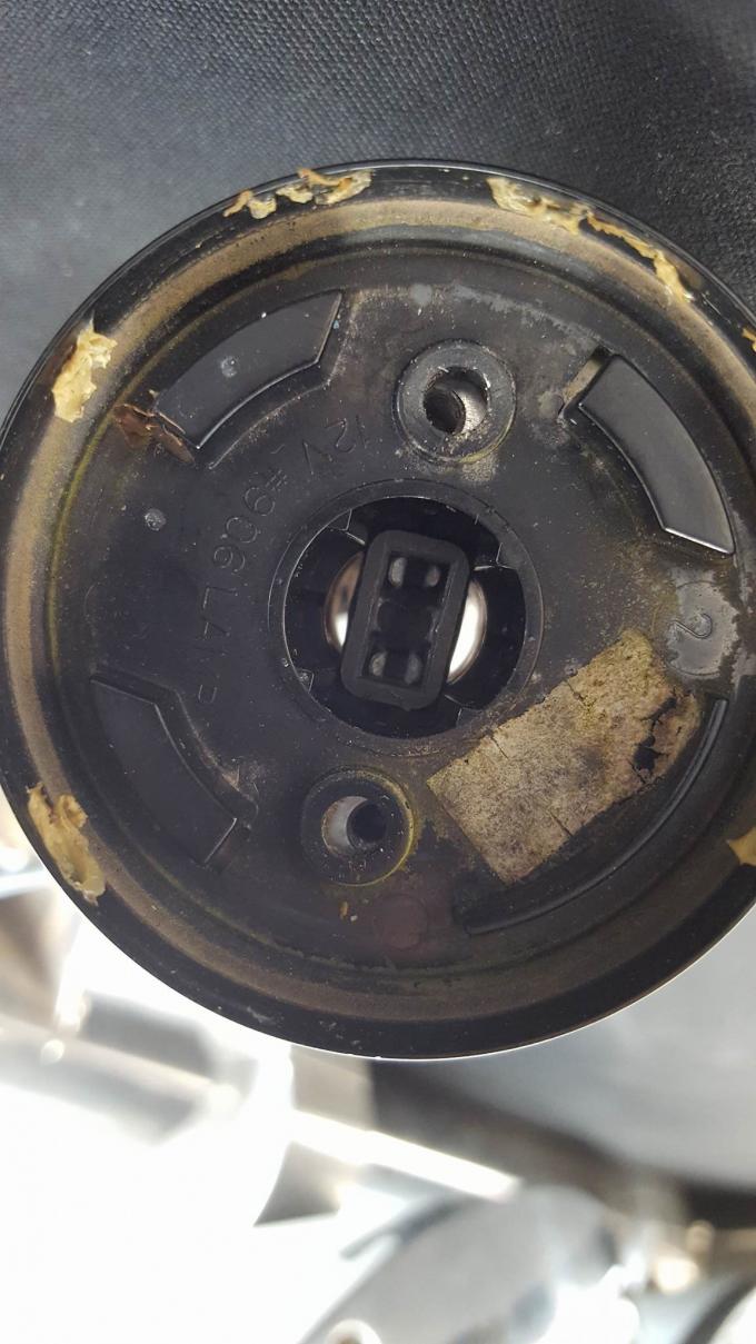

    Hi,
    I lost the cap of the anchor light on my SAN 230 of 2008 and, also, the bulb (the cap came off due to vibration). I retrieve the cap but not the bulb which must be at the bottom of the lake
    I find a reference on the socket - 12V 5W #906 - (see pic below) but I'm not sure about the kind of bulb needed. Where I live, in France, I don't find a "#906" bulb... Anyone have a pic of the proper model ?
    Thanks !

    You can look up a cross reference online

      I check the cross reference for the 906 bulb model, it appears to be replaced by model 921 / 194 which also corresponds to T10 / T15 bulb (I think that 921 / 194 are US references and T10 - T15 are Europe references for same bulbs).
