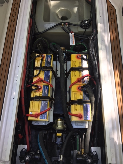

I'm going to do a 2000 watt amp for a 12 and was wonder your thoughts on switching to those big 2150 Stingers. Two enough or should I do 4 or is it even worth the money?. I've been explained that the big batteries are similar to a capacitor and by not having them low voltage can smoke a big amp.
