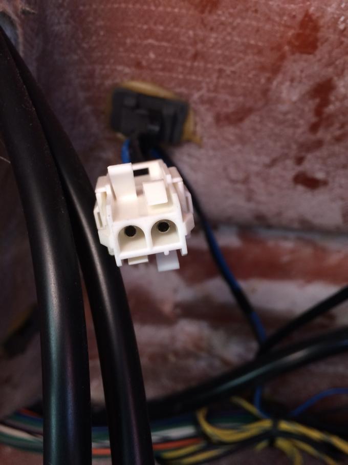

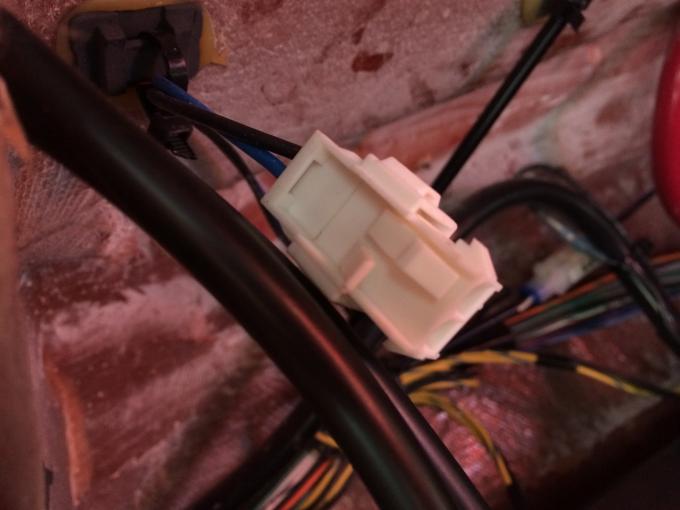

I am trying to add cupholder lights to my 2015 G21 and I cant figure out what kind of connector this is. I think I have seen some Deutsch connectors on the boat but these are definitely not them. Any ideas? Thanks
To me, it looks like a Molex part. Generally speaking only Moles, Deutsch & Amphenol -AMP (mostly compatible with Deutsch) use round terminals. I work for a company that builds some wire harnesses.
I did a search and it looks like this is a Molex MLX Series Connector

So it is a molex connector, I had a hard time navigation the waytek link above. I found them here

it was super easy, I just bought one cupholder as a test which worked so I just bought the rest. It is pretty easy, hardest part is finding the wire harness as most of mine were tucked away in hard places to get to. You will also need
http://www.newark.com/webapp/wcs/sto...&storeId=10194
It is a little tedious to crimp these but not bad.
Some of my cupholders required a screw driver to pry out.
Mine are wired into the courtesy light switch in the LINC.

I have a plug at each cup, if you don't have courtesy lights you should find a bunch
I should have asked earlier, what AWG (ga) is the wire going into these plugs. In addition, if anyone knows, what AWG wire is on the LEDs that most of you are connecting to?Originally posted by JakebI have a plug at each cup, if you don't have courtesy lights you should find a bunch
Also, which wire is the 12 VDC + and which is the ground? I would assume that blue is 12 VDC +, but I have been wrong before.

Pretty sure it is 16 ga, my test I did was blue + and it worked like a champ. If you order the parts linked above it should work. Only thing not mentioned is I got my cups from Nautiqueparts.com
