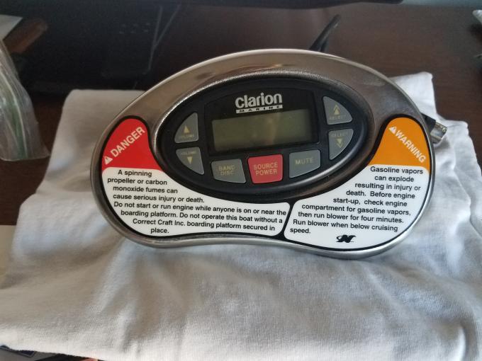

    My SN206 has the old style oval remote in the stainless steel bezel. I removed the bezel and the Fusion NRX300i can’t mount in the existing stainless bezel without being offcenter and showing some of the previous oval hole. I want the installation to look OEM. This boat is too nice to have things tacked into place. Nautiqueparts.com offers a similar bezel for the newer style round remotes, but that doesn’t help me with the Fusion. Since I can’t cast custom stainless parts at home, my plan is to use the existing bezel to make a fiberglass female mold. Using the mold, I can then create a new bezel, also from fiberglass. As long as I integrate the mounting bolts on the back in the correct place, I can then cut the hole for the Fusion remote wherever I want it.

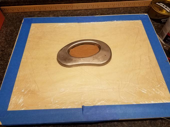

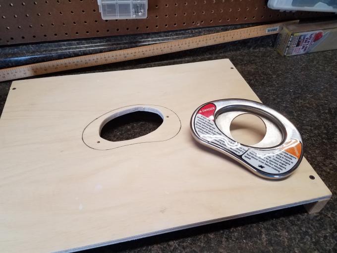

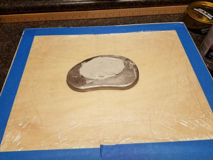

          Finally started this project. Got my work table started and the old bezel prepped to use as the first mold.
          First pic work table to fit the bezel.
          Second pic is bezel prepped and saran wrap around table.
          Third pic is first application of Bondo fiberglass putty to fill the hole for the old remote.
