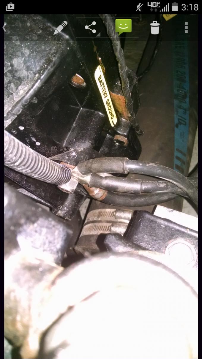

                  Working on this currently... But mine is a 2012... Not sure where to connect the stereo ground to the amp's ground...
                  do I cut the stereo ground at the fuse in the glove box? At the back of the head unit? Where it is attached on the engine? Click image for larger version

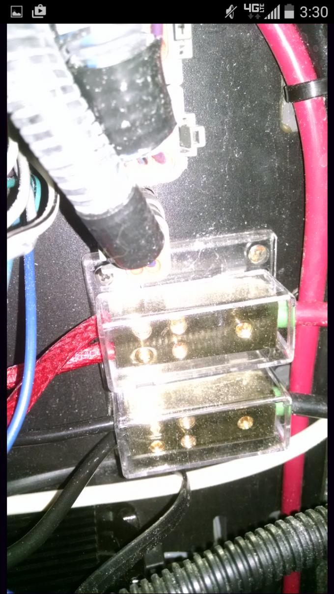

                    I understand this is my final target (I think?) But I dont know what ground wire to attach here? Click image for larger version
                            Head unit ground? same place electrically as the amp(s). just close as possible.

                              So from the head unit? (Meaning not from the fuses) thanks MLA
