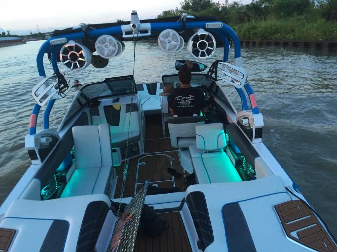

I had 1 12 in a probox ported with port towards back of the boat sub facing to the out side I put a vent that I made to look like the interior speaker covers under the seat and took off garbage door I had more than enough bass and it could be heard everywhere in and out of boat
The only thing I might have added was another 1 under the seat that flips up but it sounded so good I did not want to risk messing it up I drew out what I wanted and had it cut on my friends plasma table it looked stock and was as large as I could go in that spot it went from edge to edge then I just pot that black speaker cover mesh stuff behind it so you could not see in.Last edited by chrisschweda; 02-21-2017, 06:56 PM.

chrisschweda: Do you have a close up pic of the vent you put below the seat? Appreciate the tips! My wife is freakin' out at the thought of me taking a saw to the new boat and cutting a 'giant hole' in it...
Picture might help calm her nerves...
Thanks.
