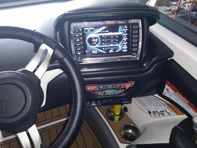

                            ws220 all the way i lv it Click image for larger version
