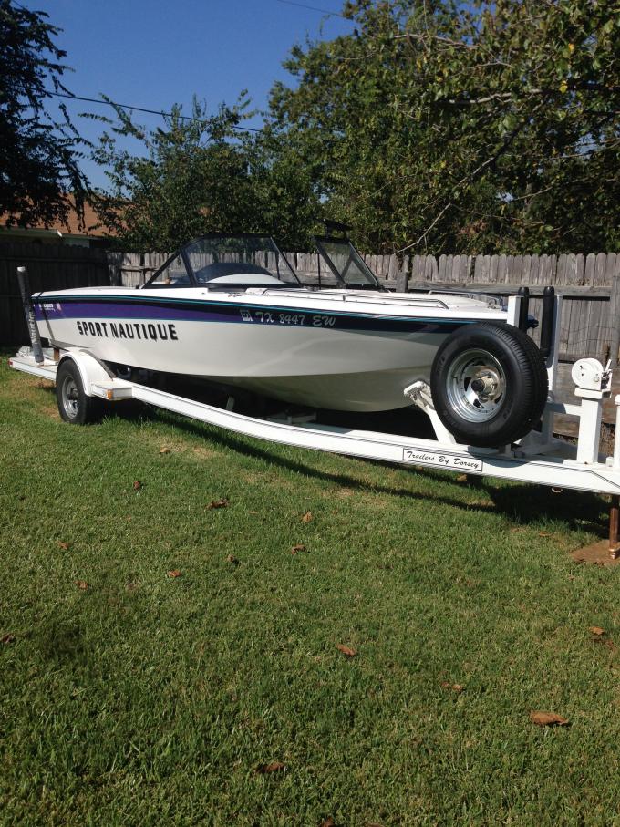

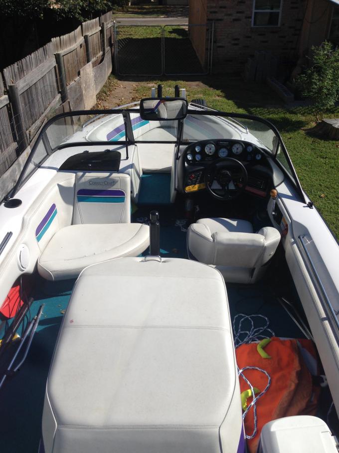

        My budget is very flexible, I'm a single guy and enjoy being out on the water more than anything else I have ever done. Barefooting, or at least attempting to barefoot was one of the greatest adrenaline rush's I've ever had, and the feeling of being on top of the water with nothing on your feet is beyond words. I'm new to the sports besides tubing behind an old fish and ski. But so far I've managed to learn how to get up and carve a little bit wakeskating, and haven't been able to find a wakeboard I like at a reasonable price. I mean i'm a beginner and spending 300 - 400 on a board right now just isn't a major priority. My priority is the boat because I enjoy driving around the lake by myself and taking a swim or two in the summer time on the weekends and chilling out in a party cove. Things i don't like right now is that the radio that's installed is currently cutting out at around half volume and with the motor running your lucky to hear it on the swim platform. with the motor off you can barely hear it when your hanging out in the water at the swim platform. I make decent money and with winter coming up spending around $2000 for awesome tune's is no big deal. I could even swing $2500 but as always cheaper would be nice, but i dont want to sacrifice quality. I've been looking at the Neptune 8.0 from roswell and may consider buying them, yet i haven't really heard anyone talk about them, and those two speakers alone with a amp and wiring kit is $2000, but if i went that route,I'd step down to some decent enough in boat's and focus more on the tower speakers. I believe the Roswell's even include the new Cybox bluetooth box, to get rid of the head unit need. I'm not concerned with the driver's ears or mine for that matter when i'm driving to provide the rider with tunes. Most of the time when I will be riding, Itll just be a few of us on the boat who all like loud music, other day's ill just turn it down lol.
        And what about the JL audio Subwoofers, that don't need an enclosure (JL audio's words) to deal with space issues on the boat. i think a 12" runs $699 on their site, but again no reviews on to how well it actually sounds, i might have to youtube the serial number and see if i can find anything on it.
        kylem03 Thanks about the tower, I stumbled upon it in one of the forums on here, and when i saw it i knew i had to have it.
