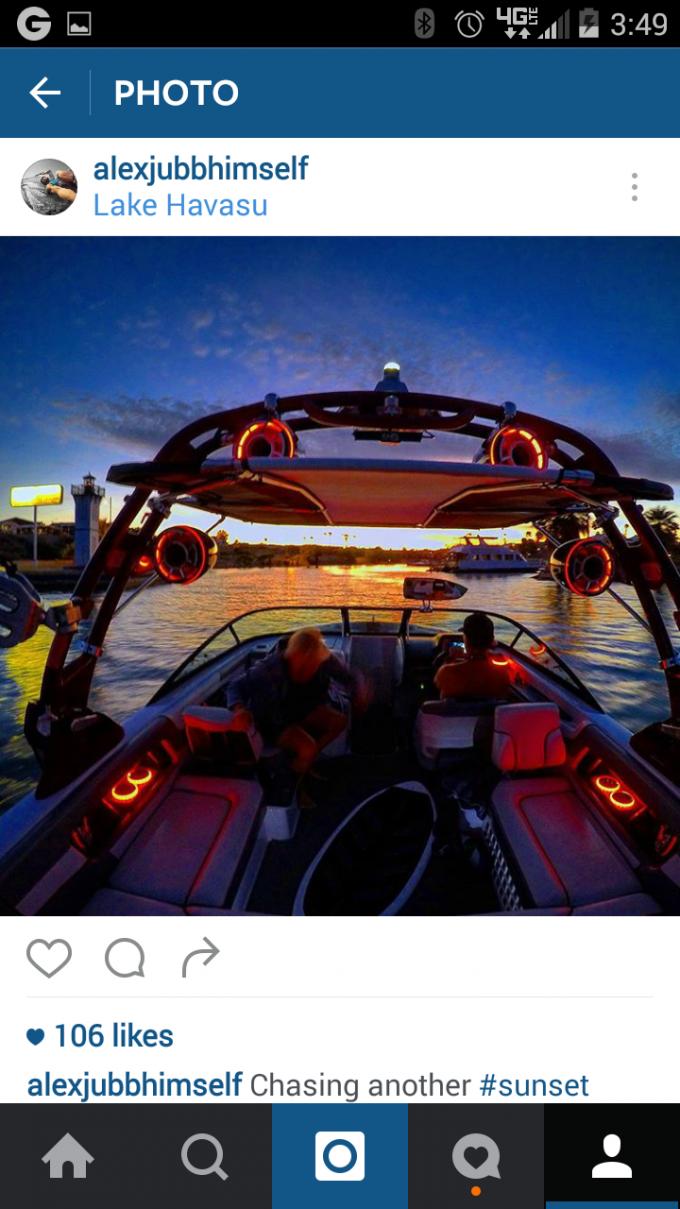

                      • nautiques4life
                        • Jan 2009
                        • 699
                        • SoCal
                        Nah, went full custom- im part ginger and i needed bigger coverage for the 120° temps we occasionally get out here. No extenders, since the bimini was built after the stereo- all 4 are on wetsounds swivel clamps though. Click image for larger version
ID:	500106 I dont have much on my phone... Heres a screenshot to give you an idea... You have an Instagram? @alexjubbhimself has some more shots of the boat.

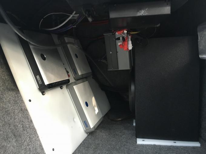

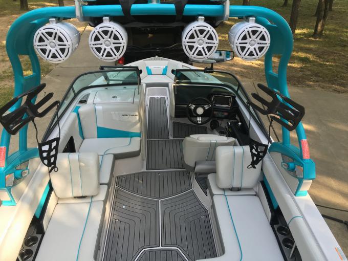

                          • Neverenough
                            • Sep 2012
                            • 907
                            • Ft. Worth Texas
                            • G
ID:	500292 Click image for larger version
ID:	500293 I switched to all JL on our 15(should have waited) and love them. I've had a full Wetsounds boat with 808 and rev 410s and prefer the full range sound of the JL. The JL isn't quite as loud but it's just cleaner sounding to me. 8.8 towers on HD600.4 per pair and m650 on m 600.6 in boats.

                              Hey Neverenough do you have a vent for subwoofer? If not how does it sound without one?
