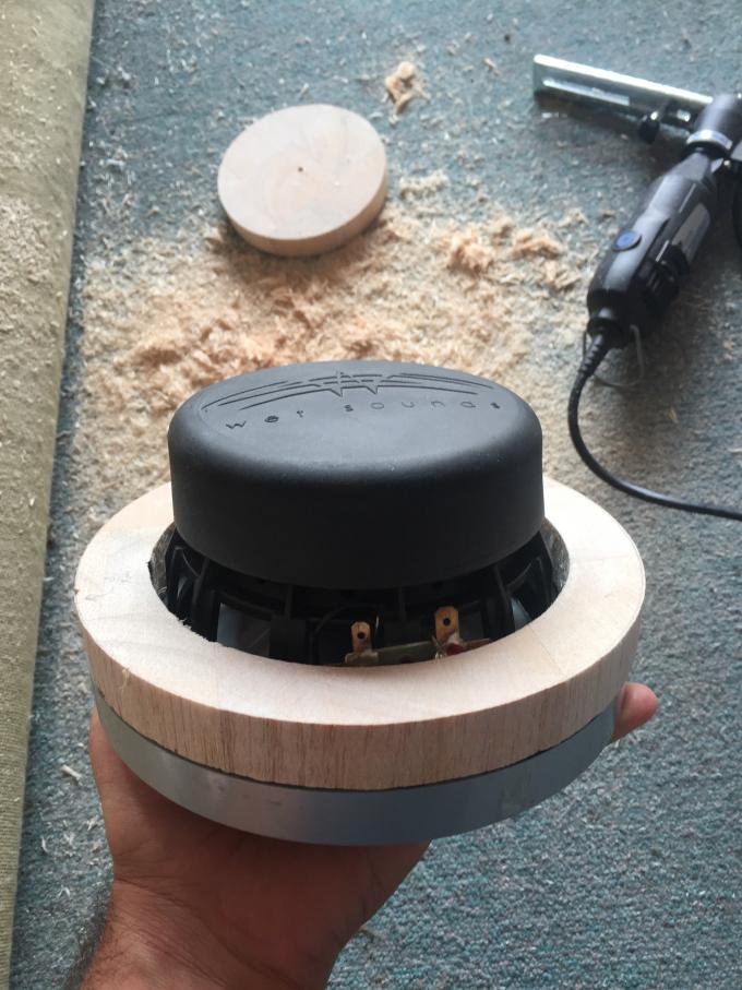

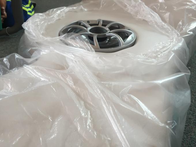

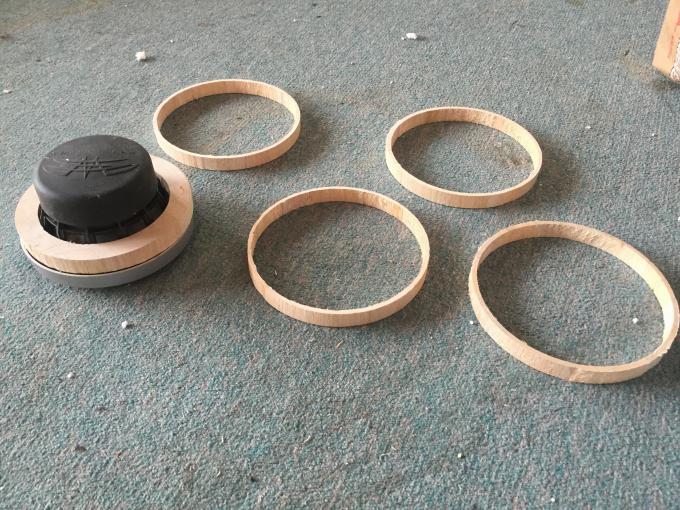

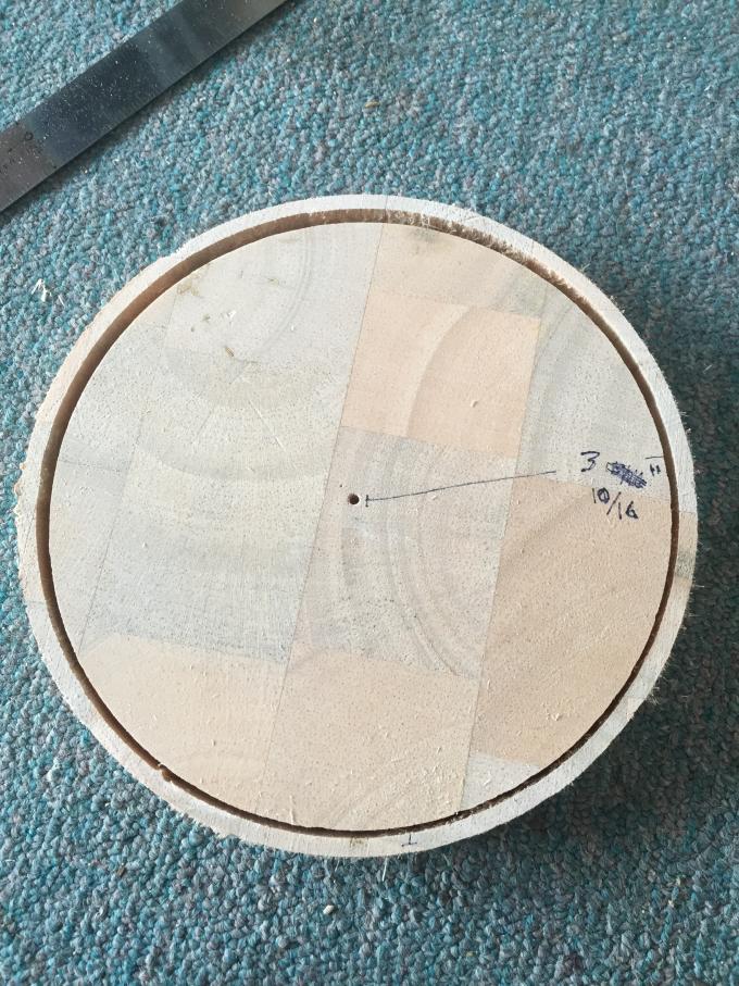

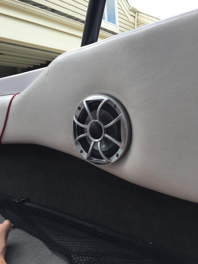

                        An option if you wanted to would be a flush mount from the front. It's not necessary but looks cool I think. Depending on how thick the foam is in the combing pad you would need to build spacers. I'm working on this currently with my boat. My plan is to build an "outer ring" that is just larger in diameter than my XS650 speakers. That putter ring will go under the upholstery then my speaker with the spacer will just drop into and be secured to the white board of the combing pad. The outer ring will keep the upholstery supported and prevent it from creasing or bowing in speaker goes in. The profile pic of the speaker flush mounted is without the outer ring and you can see the upholstery is disfigured around the speaker slightly which is why I'm going to try the putter rings. Below pics I'm just mocking up the rings and spacers with balsa because I had some laying around that was the right thickness. I will likely use a stronger material like cutting board or hard wood coated in resin to water proof it.
