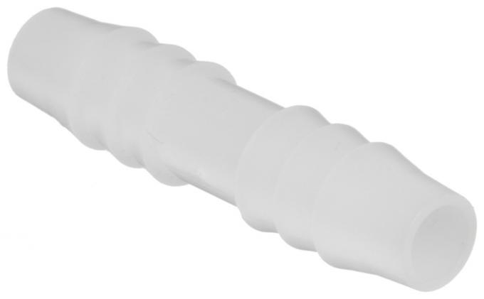

          I did that same setup in boat after making my own acrylic rings in my old boat and not being satisfied with the amount of diffusion. I tapped right into the courtesy lights, and have always done red and have no issue with bugs. As soon as I tried blue or turn on docking lights tho they come in mass. FYI, if you go this route use the 3/8 polyethylene tubing (it looks frosted, not the clear vinyl tubing) and then 3/8 nylon barbed couplers like this: https://amzn.com/B008TSTT34. You can find them for $1 a piece at Lowes/Home Depot. The 1/4 tubing inside the 3/8 is not strong enough and will kink not giving you a perfect circle, and the 1/4 aluminum round stock will leave a dark spot in the ring.

              rlwagens.. those amazon couplers look good, what is the difference between the 3/8 and the 3/8x1/4.. is that length or internal size? Which did you use? Thanks

                This is the type I actually got. No ridge in the center so the tubing can be pushed together and looks like a continual piece and hides the barbed fitting. 3/8x1/4 is prolly smaller on one end to connect a 1/4 ID tube to a 3/8 ID tube. 3/8 would be what you want. If the barbed fitting is too long just cut a little off each end with a knife, only need 1-2 of the actual barbs on each side for it to hold.
