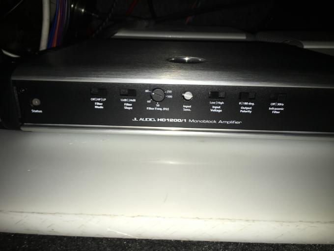

Well I installed HD1200 and I can't say I'm very happy with it. Moved the Treo to 4ohm load retuned the amp per JL guide in book which was the same as how I tuned the Crossfire. It sounds ok but doesn't have the same solid thump as the Crossfire did when it worked. I guess I'll go get a Treo amp????
I added a pic of tuning on amp incase I missed an adjustment???

Then there is definitely something missing in the execution or elsewhere in the system.
Perhaps you could give your JL Audio dealer a shot at tuning the sub.
Why 80 Hz? Why a 24 dB slope? Sealed or ported enclosure? Set amplifier gain with speakers disconnected?
Comparing it to another amplifier/sub combination that worked for one outing?
