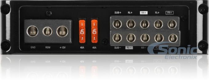

            Which amp? Do you have the stock Polk amp? I am amazed this does not happen more often because they wired the 2 cabin speakers on one side to a single channel. They did this with 2 Ohm speakers to create a 1 ohm load.
            Check the fuses you can see here. I wonder if one of them is blown.

                  When this happened on my 15 G21.....the light on the amp was off...amp was bad. Cockpit speakers where not playing. They put in a new amp...boom....cockpit speakers back to normal.
