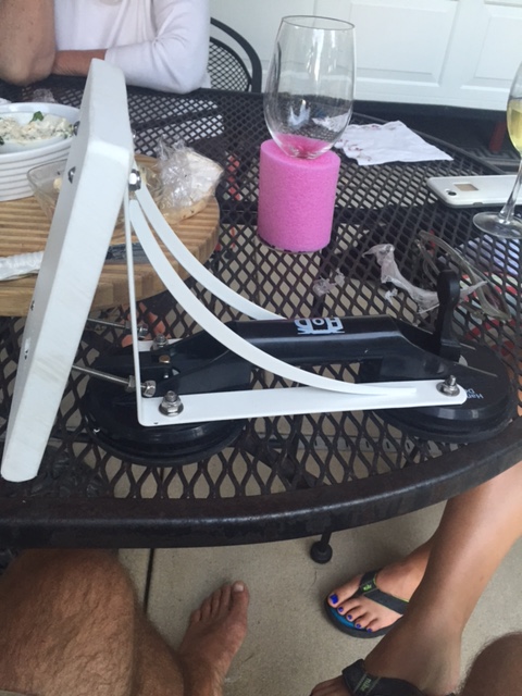

    How are you guys locking down the suction cup that is by the plate? Seems like it is to small to get a hand in there...
    it is kinda tight to get the front latch depressed, that I believe is the only flaw mine has, but it really isn't that hard to stick your fingers in and push down, I just latch the back one first to hold in place and then the front

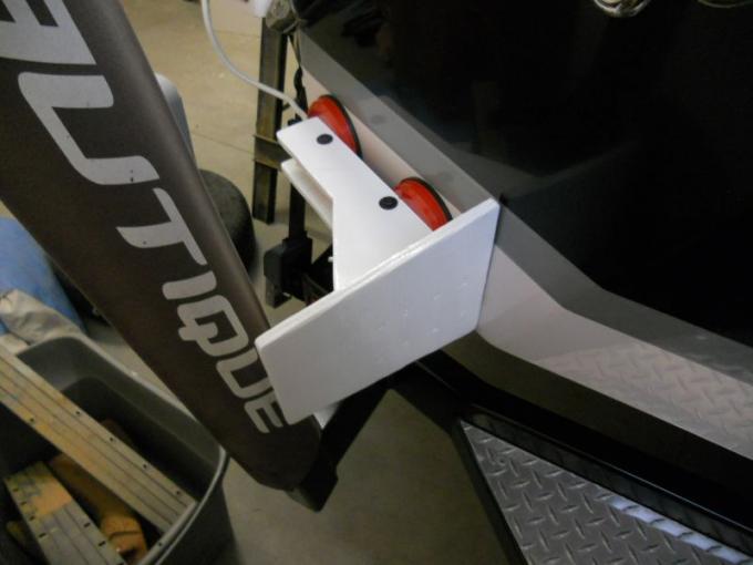

                  GAME CHANGER!!! I went with an angle on my gate, the three inch bolts on the bottom are for the greatest angle. I cut the gate panel to 8"X6", and cut the handle off the front suction cut to have gate panel as low as possible. Only issue is the HOD is starting to loose its suction, but its ridiculous on my 08 SANTE. I fill everything i can, back piggys FULL and front stock FULL, we filled the boat with people and it was so big!!!! But with only my GF and I and the ballast as full as we can get it, we could ride perfectly. we were riding at 11.3MPH. I ordered new cups with metal frame, it hasn't came in yet.
