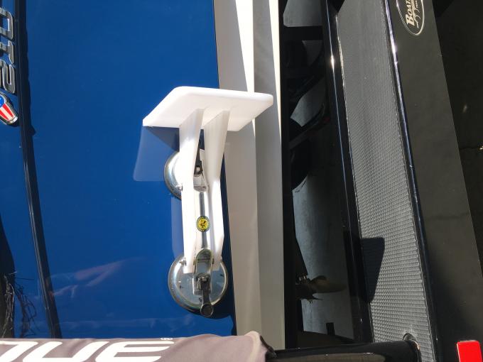

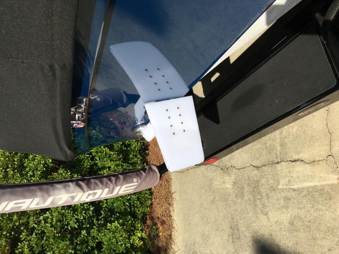

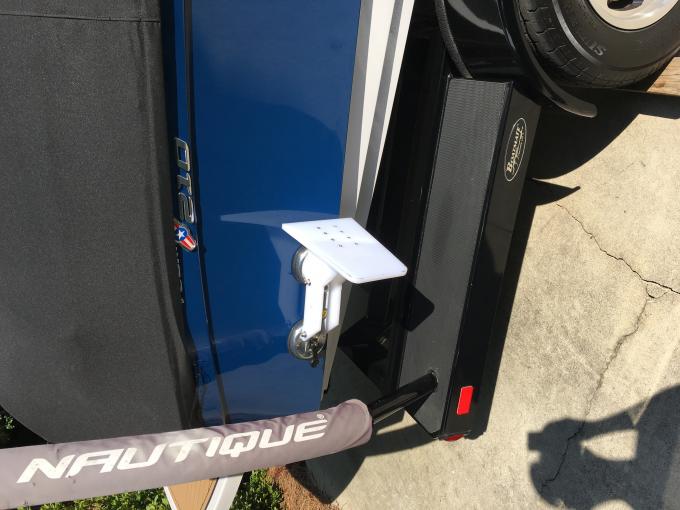

    Here's mine. Click image for larger version
ID:	489042 Click image for larger version
ID:	489043 Click image for larger version

                      Originally posted by Evening Shade
                      I made one almost exactly like nr2041's and it did help the wave, but I still can't seem to get it dialed in. The wave is tall, but its very short and close to the boat and washes over very badly. I need to figure out how to distribute the weight in the boat.
                      for your boat I would open that angle up, remember we are mounting to an angled surface where as your mounting location has the cups perpendicular to the side of your boat, the idea is to mimic how malibu's surf gate works, move the plate back as far as possible and angle that plate back some
                            I will try that. The angle on mine is only about 10 degrees. Any idea how many degrees yours is?
                                around 25 degrees, I made this one tonight for a buddy to try on his mojo 2.5, if mounted perpendicular to the hull it has roughly the same angle as mine when mounted to the angled back hull area
