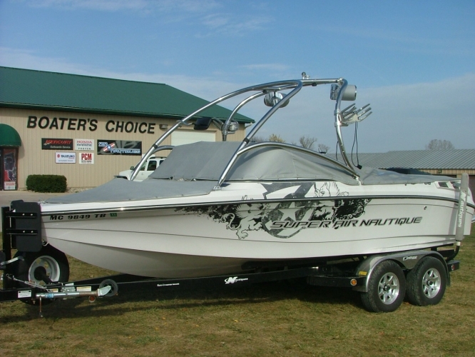

          Here's a shot of a 210:

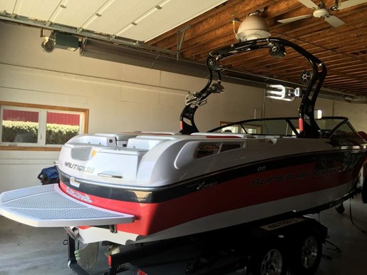

          And here's a shot of a 230:
          Does that help?

                It looks like the 210 and the 220 will probably be ok, but the flat section on the 230 could be half way out of the water with a lot of list

                    Lots of great discussion going on here. Typically we recommend placing the Delta so its at the waterline when the boat is fully ballasted ready for surfing. The 230 looks like there is a good space about even with the swim platform, that's usually a really good spot to start. Someone asked about listing. That's one great feature of the Delta. There is no need to list. We recommend starting with the boat evenly ballasted side to side.

                      Im sure there isnt a NEED to list the boat, but since you cant switch sides mid run (like the NSS) I imagine that most people will still list their boats as much as they do now.
