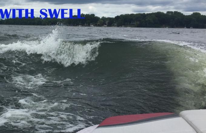

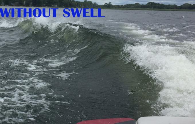

      How much weight are you guys running? here's a pic of my 2002 with both 750s in the rear, 600 in the locker, and 400 up front. That's with my SWELL Wakesurf Creator attached just in front of the angled part about 2" below the water line. My buddy has a '16 RI237 and while his wave is bigger, not nearly enough to shell out the cash for . . . The other pic is with the boat listed, so only one side tank full, everything else full, but no wakesurf shaper.

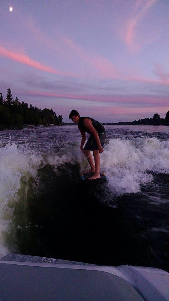

            Guys, here's a users video of the SWELL Wakesurf Creator on a 2007 236. Hope this helps.
            https://www.facebook.com/jim.telloia...5669618131566/
            and a pic:

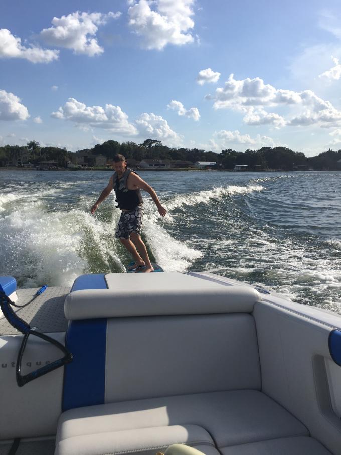

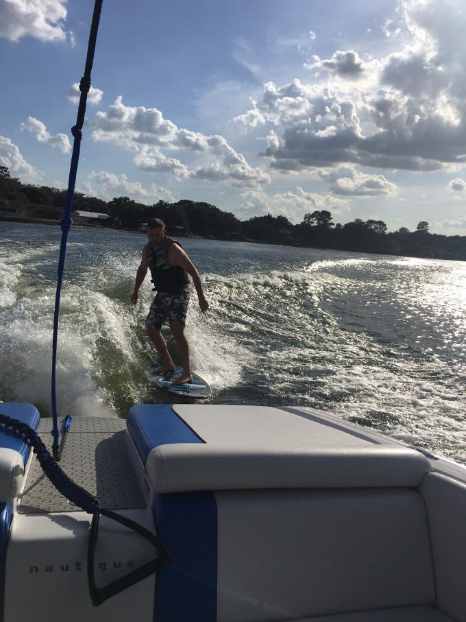

              Here are the pics that i took the other day when i was out. I was driving so it made it a bit difficult to get a good angle of the wave. I am still working on placement.
