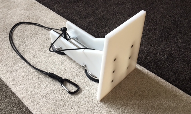

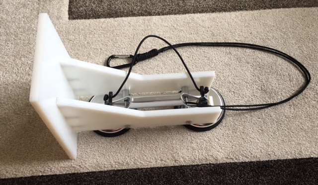

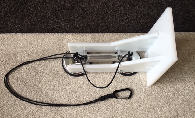

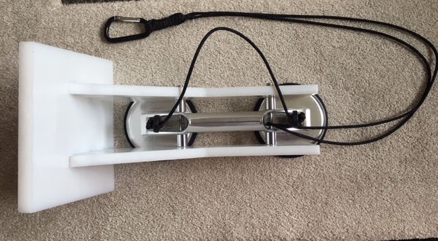

    Here is my second "suckgate". In his attempt to be co-captain, my son (19) has taken a lot of the responsibilities on the boat and is doing a fine job with a few rookie mistakes along the way. After a fun day out on the water he wanted to take a last set. I had him attach the gate. He gets up surfing and the wave goes from crisp curl to wash, I immediately knew what happened. He didn't fully depress one of the suction cups. Looks like our bungee kayak tether didn't work either and to the bottom of the lake went the suckgate!
    I took this opportunity to modify the second gate a bit. 1. I used 3/4 chrome engine spacers instead of washers. Doing this allowed me to spread the two side pieces out further to accommodate easier depressing of the suction cups. 2. I used smaller diameter bolts for a cleaner look. 3. I used smaller paddle screws so it wouldn't bulge out the 1/2 HDPE. 4. Spent 30 mins learning how to tie 550 paracord for a stronger tether. All in all I feel these mods will help in ease of use.
    I have already tested out my old suckgate and it works awesome. I finished my ballast system upgrade thanks to wakemakers, 3 reversible pumps filling 2 -750's sacs in the v drive lockers, a 580 sac in the belly. Fills in about 6 mins!! couldn't be happier with the speed and ease of use. I'm still playing around with bow weight to elongate the wave. I'll get some action pics this weekend, I'm leaving tomorrow for four days on the river!!

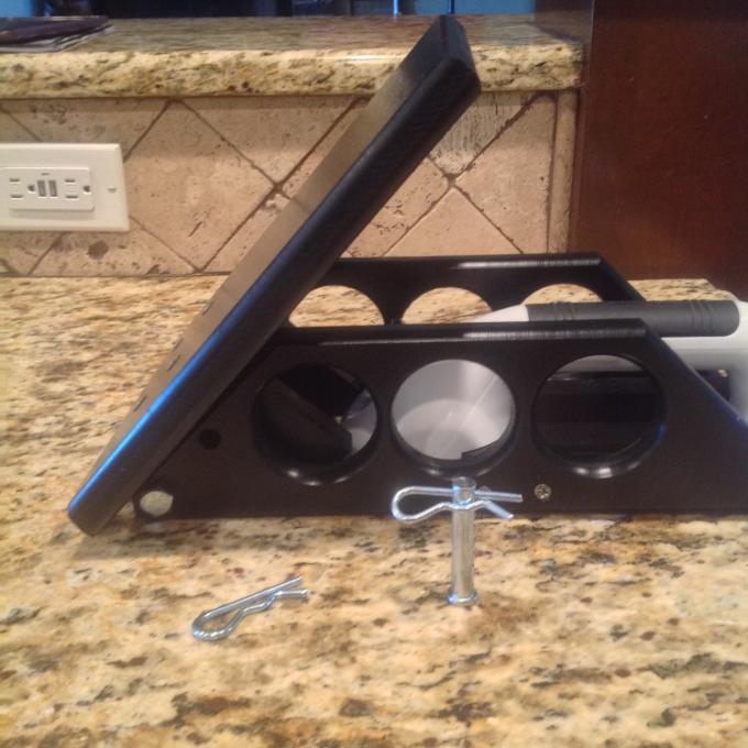

      I'm having great results with this version on a bunch of boats. Nothing to rust and all plastic exterior.

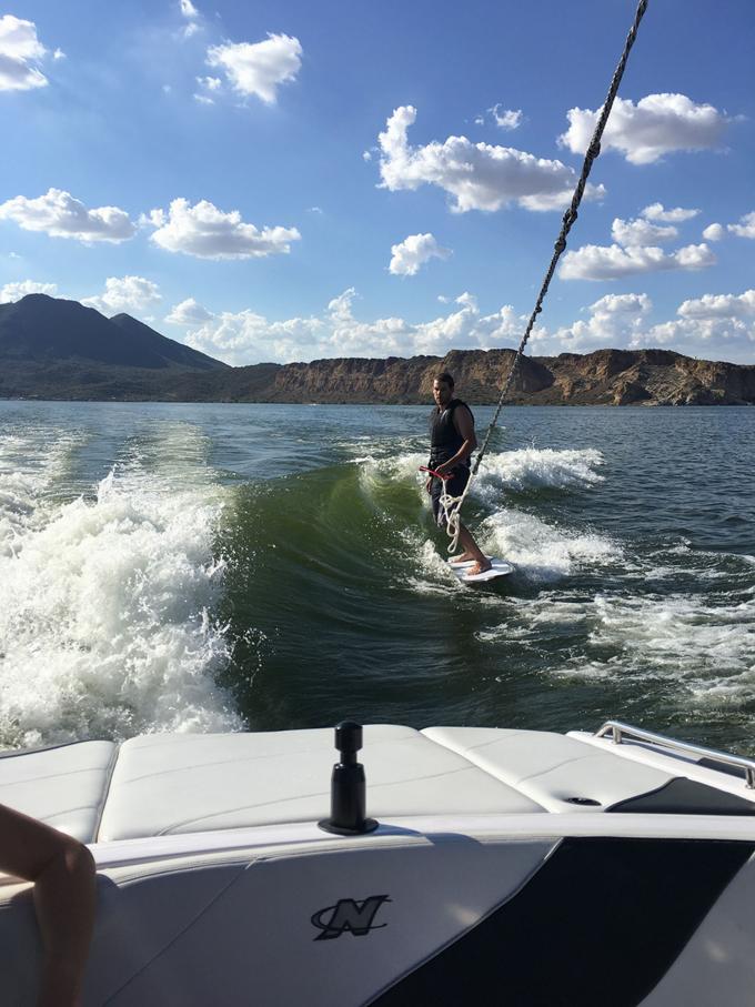

        [QUOTE=Brian Sullivan;n495321]Here's mine I copied one of the first ones but didn't like the straight 90 degree angle felt like it wasn't efficient and just dragged too much so I made an adjustable one and copied Malibu's surf gate size. Im running it on a 2001 SAN so we need more help surfing the port side than the starboard side which is where the adjustment comes in. As for the angle to the side of the boat it can be adjusted between 10-40 degrees the sweet spot for the port side seems to be right in the middle around 20-25 degrees. I attached pictures with some of the dimensions if anyone wanted them.

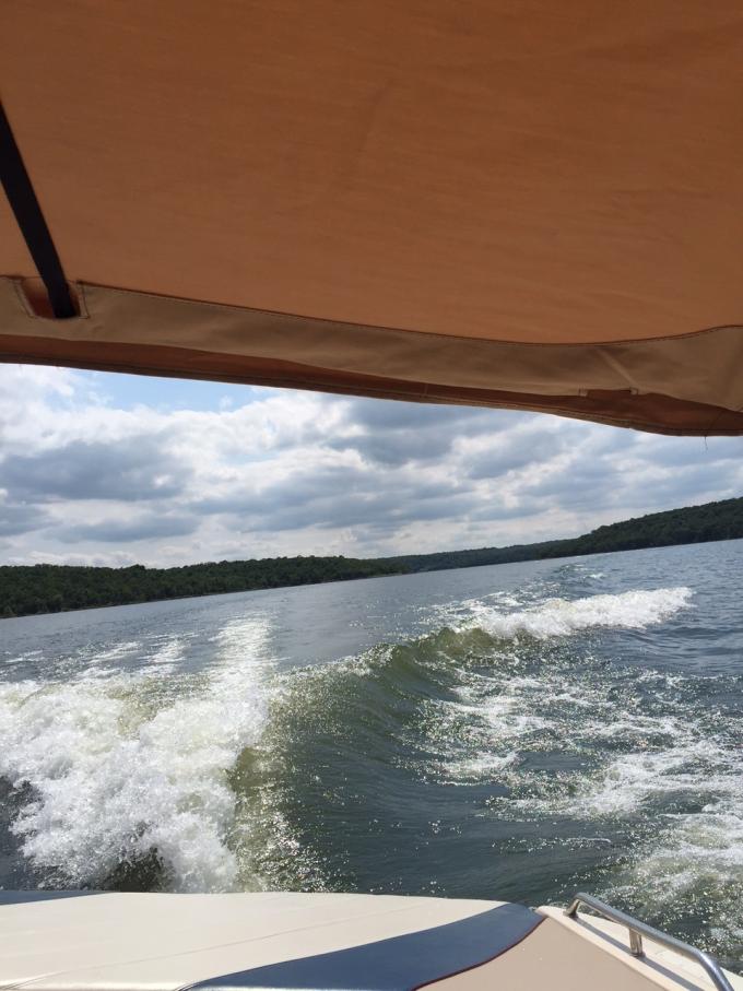

        Brian,
        I'm wondering if you have been able to find a sweet spot on that angle. I have a 50% complete gate at the house and it would be super easy to complete on a fixed angle. Also, any shots of the port? This is my wave on a 99 SSN with 650 locker / 750 port by engine @10.5. What ballast do you have and any wave pics?

          I would say when we use it for surfing the port side we are more like a 30-35 degrees from the side of the boat. My one goofy rider likes less angle but I think its just because you really don't need much to get a good wave surfing starboard. I have 750s in the rear and i try to match it up front between locker 400ish and under front seats 300 and even on top of the seats 400. I find it surfs the best with more weight up front but its hard in these little boats surfing next to the g23's
