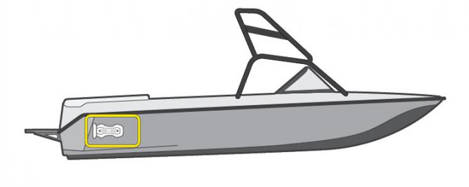

    Originally posted by cnorrod View Post
    Finally got my mission delta in last Friday and tried it over the weekend. It does make a difference in the wake, but didn't fit my 07 SANTE 200 real well. It rooster tails a lot. Needs to be set lower in the water , but can't because of the hull shape. If you can make one I would try it. Just my two cents.
    Try reversing the position of the front panel and mounting the Delta so the front panel is closest to the stern and as low as possible (even lower than the picture). I have a 1999 Pro Air and mine rooster tailed until I reversed the front panel and got it as low as possible on the hull. Also I found (at least with my hull anyway) that even weighting vs.leaning to one side also helped minimize the rooster tail. I am using factory ballast (400 lbs) and usually have 3 to 4 people in the boat and run around 10.5 mph. Click image for larger version
    Still need more river time to fine tune but it gives me a wake that is more than adequate..
