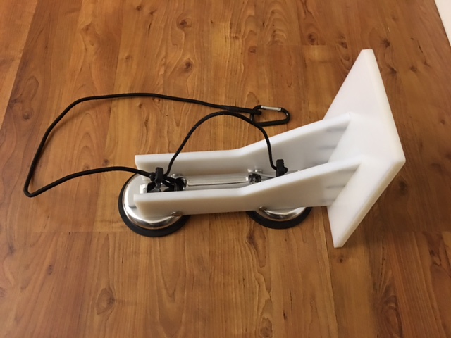

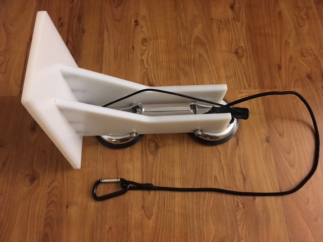

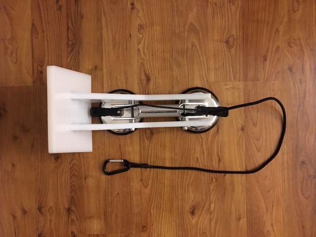

                            #193
                            Got around to adding a tether and quick release cord! I took out the entire old ballast system on my 98" SS and ordered up a ballast system from wakemakers. It's supposed comes in Tuesday, can't wait to try them both out.
